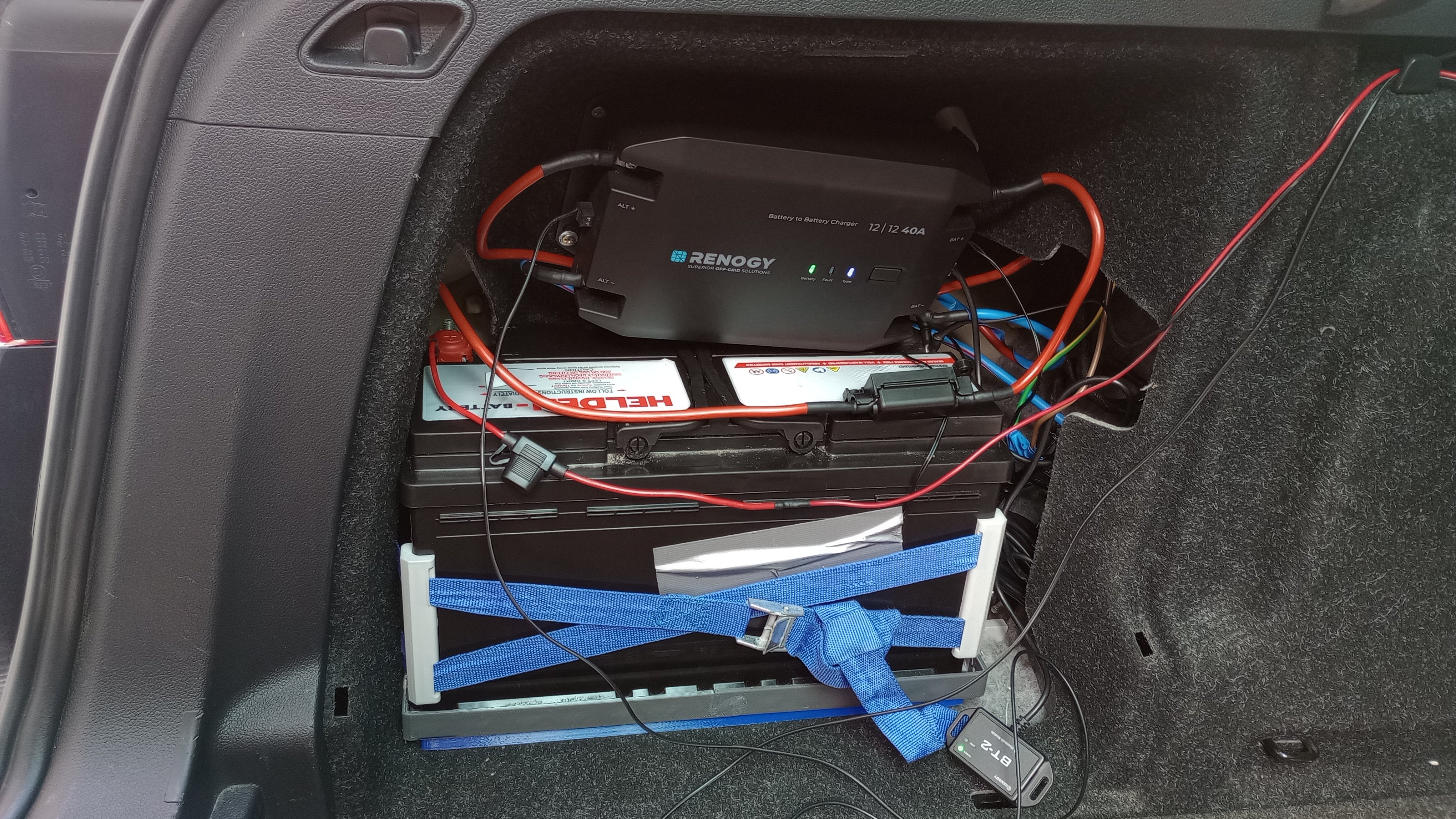

Yes I saw that and I've put mine in the same place after removing the (huge) subwoofer. I 3D printed a tray for the battery and secured it from both sides with a ratchet straps and it's solid. I couldn't find any signal which becomes live only when the engine is running so I've defaulted to a terminal 15 connection in the fusebox so on with ignition. Just need to never leave the ignition on. It seems to work ok.
