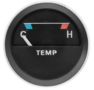

Combined (mechanical) oil pressure and coolant temperature gauge for a 1960s British car.
Coolant (electric sender and gauge) for a 1970s British car, markings left off to save drivers' worry (not that the gauges were very accurate anyway).
