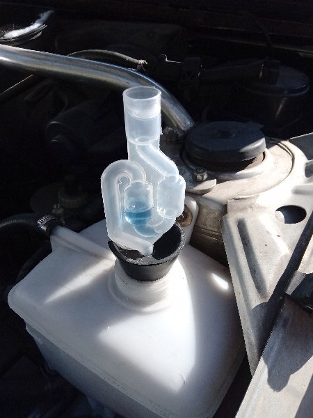

''Glitters'' inside my coolant expansion tank
That rubber adaptor will ''seal'' properly the expansion tank
and the fumes from the coolant will rise up and mixed with the blue liquid?
I wonder why we can mix coolant with few drops from Bromothymol Blue to see the reaction?

It depends on the size of the rubber adapter how well if fits and seals, if it's not big enough you could wrap it with something like Gorilla/gaffa/duck tape it's just important to get the seal so the fumes go through the hole in the centre and up to the fluid.
I've no idea about chemistry but I'd guess the kit wants the fumes.
it will just react to the ph of the coolant nothing to see, much better using a ph strip
good enough maybe it will need some forcing on your part
No if there are exhaust gasses present ie CO2 it will react forming carbonic acid, a very week acid just enough to drop the ph of the solution to 4 - 5 or so to turn it green and then yellow, its just a visual index, the same test can be performed by using water and a ph strip instead of the BTB solution.
Tip you can turn it back to blue by adding a base. Use sodium hydroxide, aka tuboflo just dissolve a few grains in distilled water and add it drop by drop back in the yellow solution it will turn blue and you can return it to its bottle

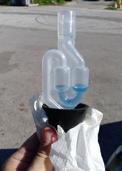

That's the amount of blue liquor that i must use?
this is how much i used its fine
Let the vehicle idle until it gets to 75-80C to then place it on the expansion tank and let it idle until the thermostat opens, then maybe 1200 rpms for a minute or so is perfect for validating...
Yes.  In that tube device (no doubt there's a name for it but I don't know or forget) if it's the same size as other available there's 2ml of fluid. - https://www.ebay.co.uk/itm/123735248113
Ok, that Syphon tube must be filled with the blue liquor.

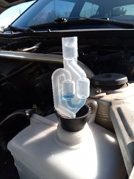

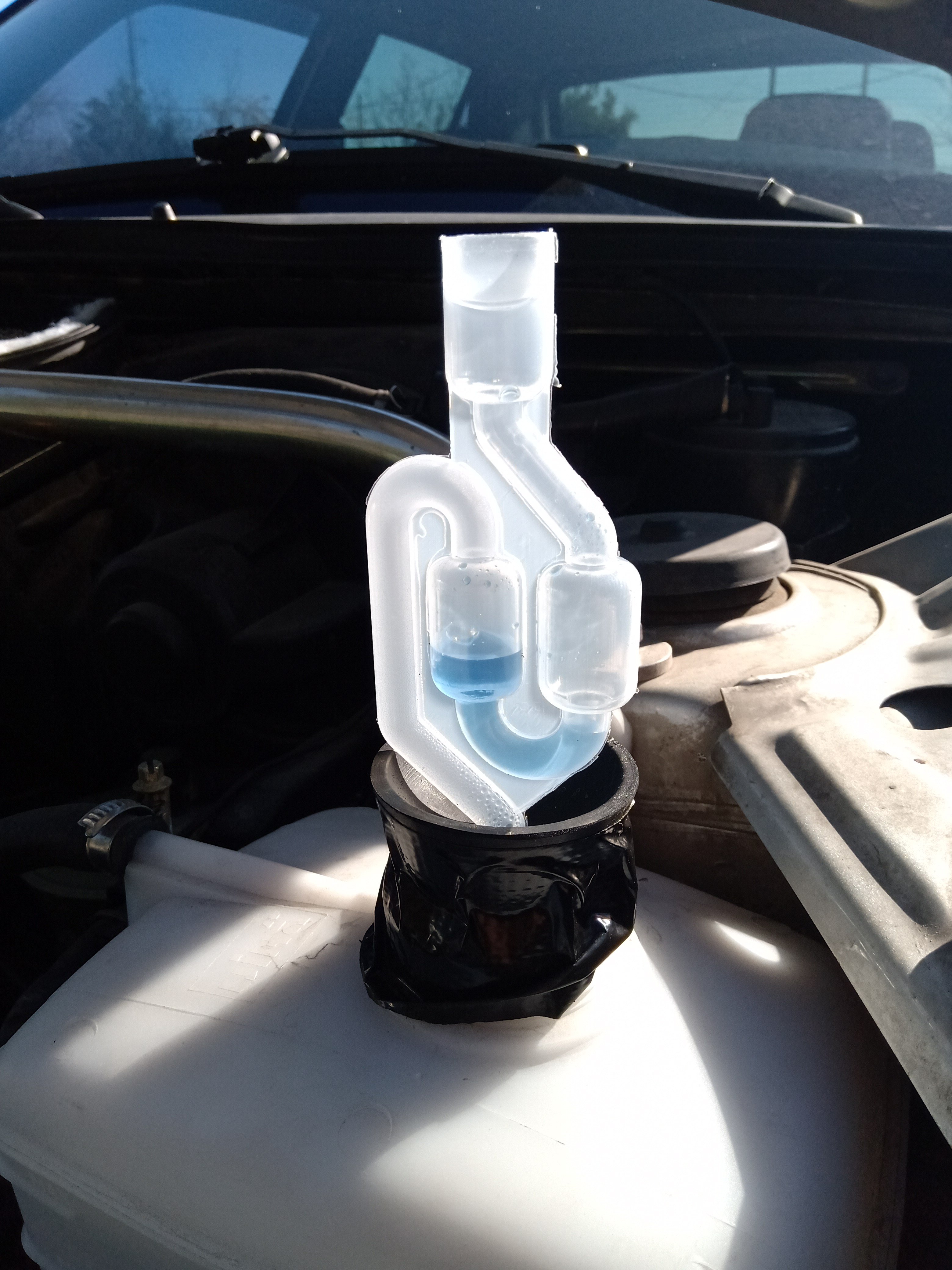

Was it done for at least a minute in elevated revs right? If so that slight color change can be considered normal.
I drove the car for few minutes in low-middle rpm,the temperature rise and the fan start spinning.
I parked the car in an alley, installed the kit drop some blue liquor and rev it by hand, the fan started again and this happened another 2 times.
The whole liquor was moving left and right depending the rpm (idle- higher) but the colour didn't changed.

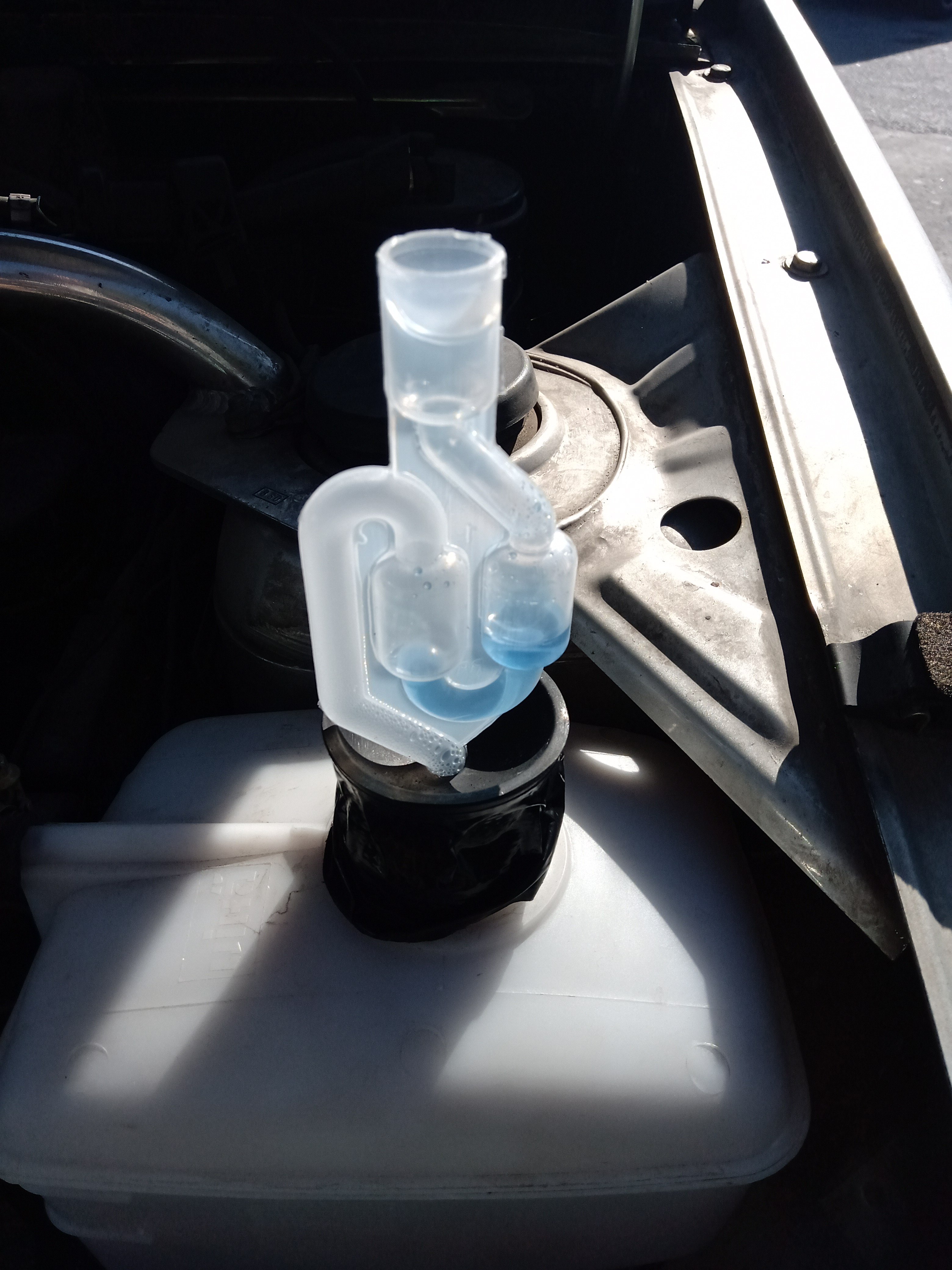

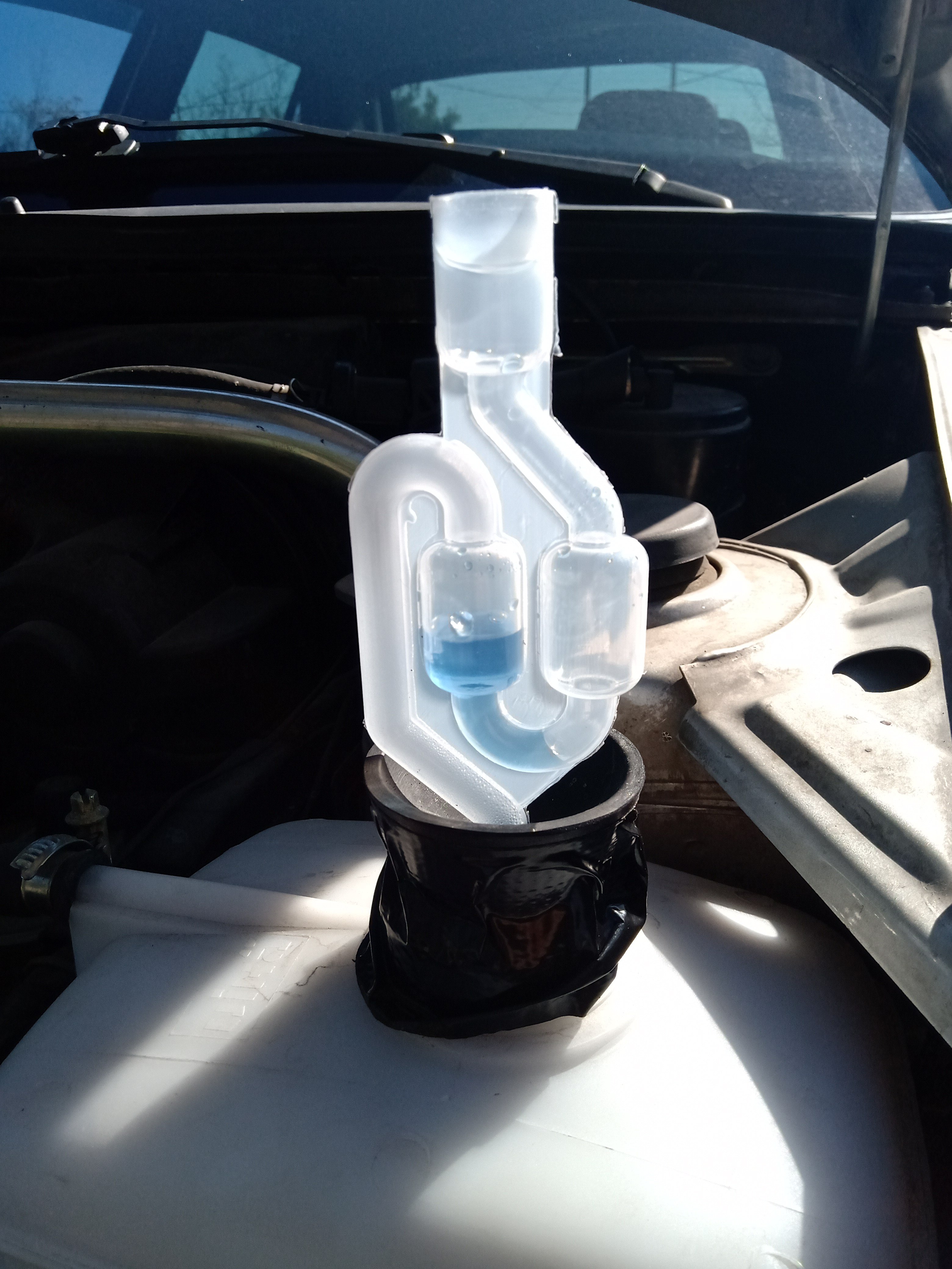

I decide to insist more to be 100% sure that's why i made a (sloppy) tape work to ''seal'' it more and insist in higher rpm revving by hand.

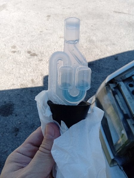

Rev by hand, after a while the fan start spinning, took a photo then let it come to normal.
This happened another 5 times at least, totally 7 times the fan start working and i think after so many minutes was more than enough for the test, if there would be a colour change it will occur already.

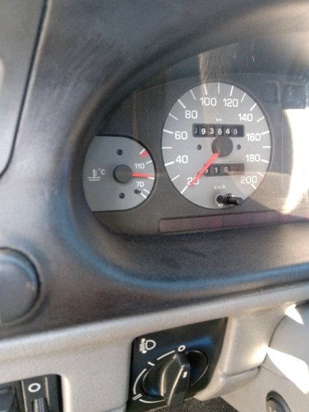

So after this ''torture'' i took a photo from the coolant temperature factory gauge, here is the highest point (as already knew it from the last trip) for my Trusty.
I disassemble and clean the kit and returned home declaring a Victory !
I think you can say you have done more than enough to confirm that test at that point of time!  Bit wasteful over filling the tube-thingy though. 😆
Now you could perhaps try letting the coolant drop in the tank until it seems to have stopped dropping then mark the coolant level at that level and see if it drops further and if so by how much and over how long.  A very small coolant leak is hardly noticeable on the tank over a good period of time/use.
On the Midget the heater tap (tap not valve as such) leaked a little and I've had thermostat housing  / gaskets leak a little, both are on the top face of the cylinder head and you couldn't tell a drop of level in the tank (solid metal tank so no marking and measuring by dipstick method would be a waste of effort for tiny amount lost).  Thermostat housing / gasket would seal by using Hylomar Hylotyte Red 100 but tap was internal leak which was very annoying as it was only 10 years old and didn't come apart for repair like previous versions - such is progress.
Edited by nta16
spelling
Your head gasket is 100% healthy I like to admit my suspicions were wrong and unfounded.
