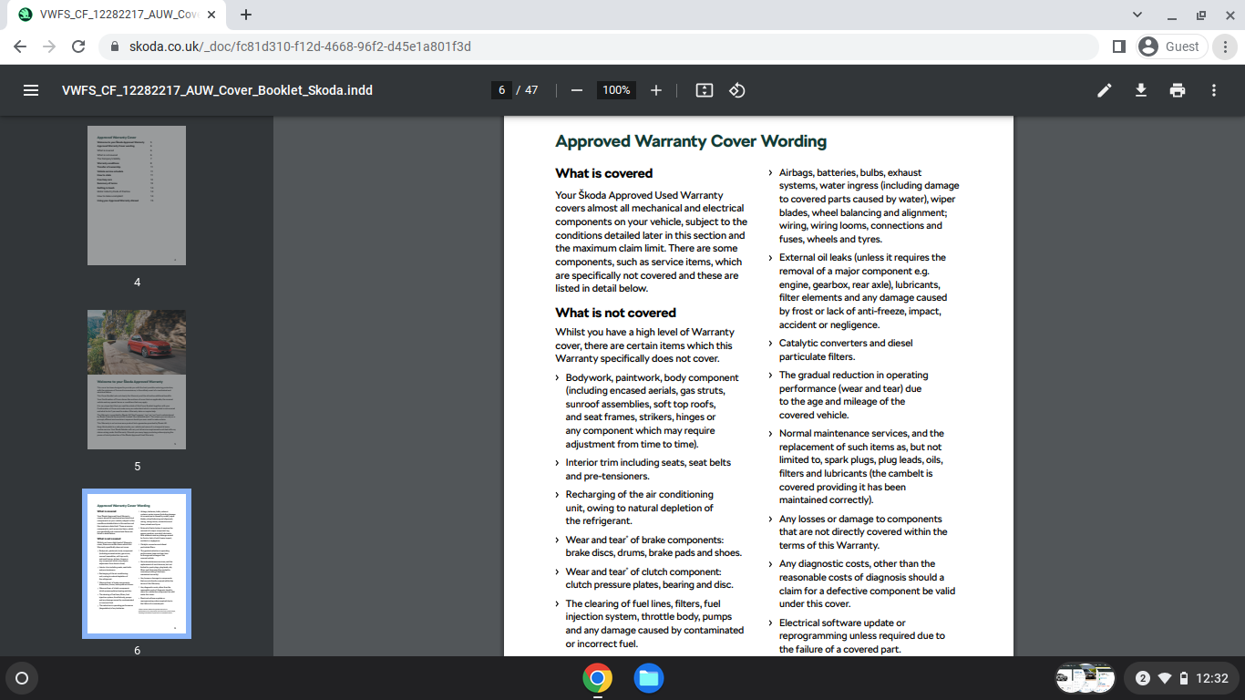

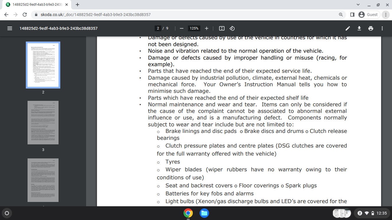

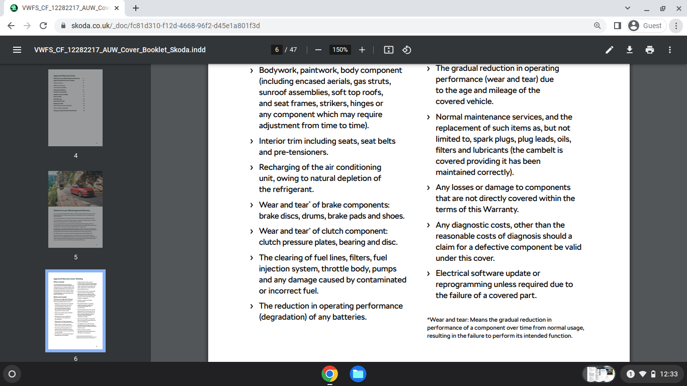

Was it a Skoda Approved Used car? With a Warranty.
Clutches are a Wear & Tear item, but with New Skoda Warranties they are not excluded.
I personally think they took the p!th if they went with Clutch Packs and no Warranty Cover.
If the car needs a Turbo Waste Gate, or a complete turbo just gen up on the Used Car Warranty..........
For any one with a Manufacturers Warranty, Extended 4 or 5 years even see that DSG Clutch Plates are covered.
Edited by Ootohere
Yeah it was an approved used warranty and I asked about the warranty but they said that the wear and tear wasn't covered 😭 all done now so I'm not going to argue that but for future reference I'm going to clue up on the documentation
Tbf that document says wear and tear is not covered if I'm reading it correctly, I imagine brand new ones would be covered but it's approved used 69 plate
