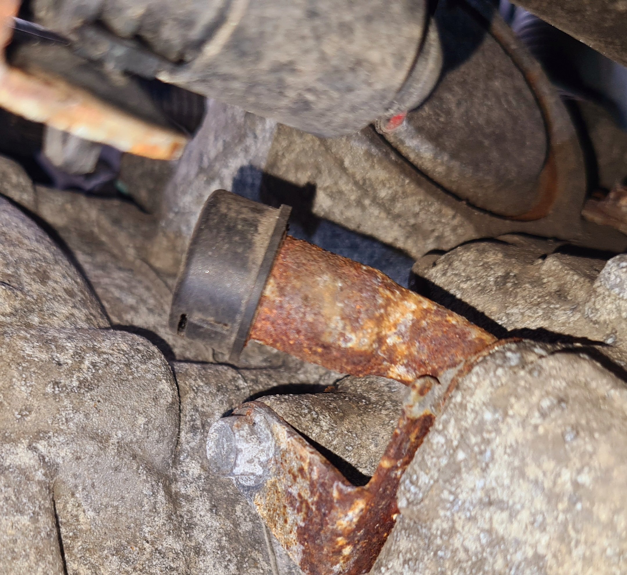

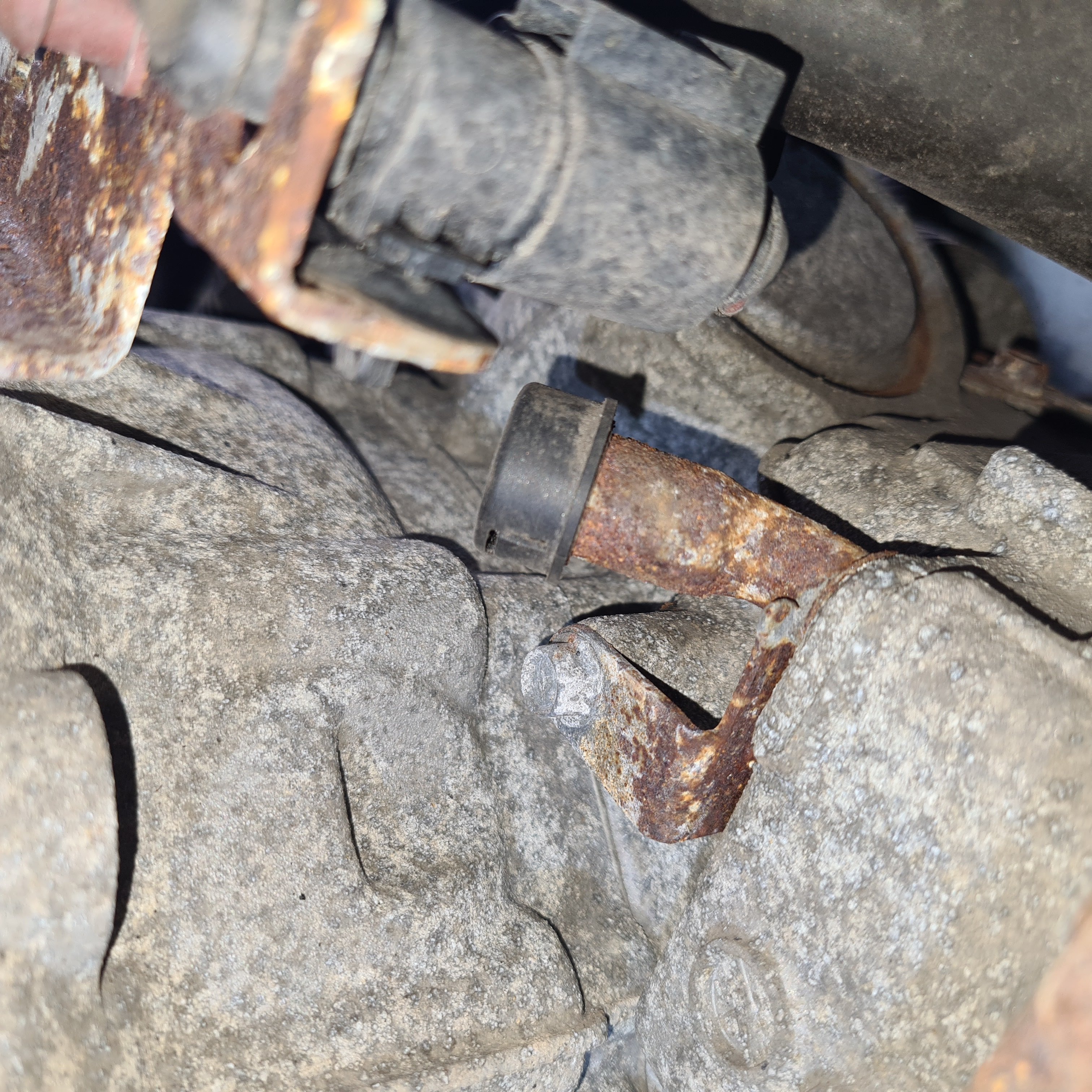

Well, I got under to take a look and I found the drain plug screw at the back of the autobox.
Next, I scoped for the filler plug and found that too with its black plastic cap toward the front.
I've ordered 5L of Comma MVATF PLUS which has the right (VW G 052 990) spec for the Jatco 001 box.
My question is, given that the box takes 5L, and I assume this is for the torque converter too, ..how do I know when I've added the right amount of ATF as there is no dipstick to guide me? 20250624_150749.jpg20250624_150752.jpg🤔

Just read it.. Its quite an involved process and what I thought was a drain screw, isn't!
It seems you drain it through the inspection hole in the skid plate but the manual doesn't detail exactly what I need to remove as this also somehow, is the ATF level indicator when filling.
Trying to imagine how a drain hole can also be a fluid level without images to explain.. 🤔
I imagine that there is a long overflow pipe inside that inspection hole which will allow the fluid to overflow when it reaches the correct level.
From the drawing, it looks like a square driver is needed to remove it.
I have 3/8" and 1/2" drivers from socket sets, so can I assume that one of these will do or will it be some VW special tool of a different size..
It's such a pain trying to guess this stuff when the car is 10miles away sitting on a gravel drive..
I'm getting an idea now how the overflow/drain plug thing works so hopefully, when I get on it, it'll not need any special tools (that I don't have).
