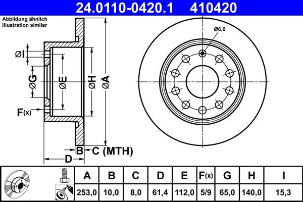

According to Jurid on autodoc, the Octavia MK3 1.4TSI 140HP/150HP has build codes 288x25mm 1ZE for the front brakes and 253x10mm 1KD for the rear brakes.
There are two versions of the 253x10mm 1KD rear brake discs. The change point appears to be the facelift in 2017.
Notice that the "D" dimension is 9.8mm wider in the late version of the 253x10mm 1KD rear brake discs.
253x10mm 1KD rear disc (early version)
253x10mm 1KD rear disc (late version)
Edited by Carlston
  • Sponsor
@Carlston typo in your post above, I'm sure you meant to write 1ZE for the front PR code rather than 1KE.
Good reminder about the rear disc depth "gotcha". 👍
