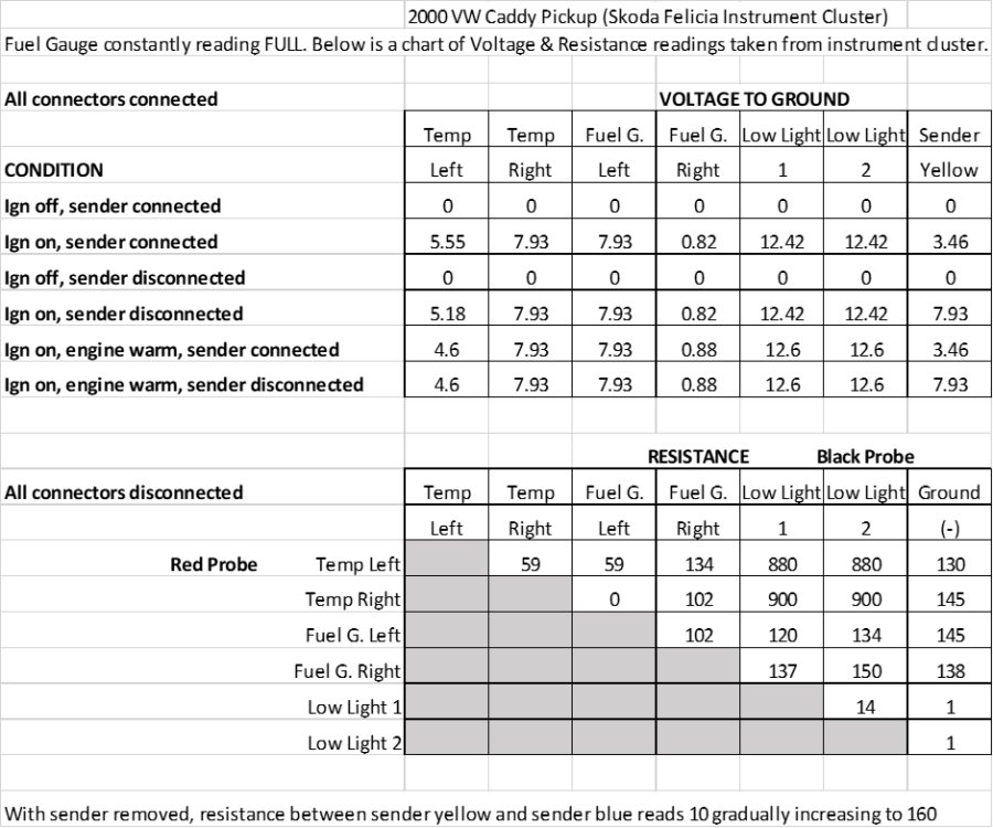

I've attached a chart of voltage and resistance readings taken from the cluster under various conditions which I hope may help to throw some light on the cause of the problem.

Though well presented I couldn't make sense of your table of figures (or scale to resistance figures) so hoped the others would dive in to the thread.

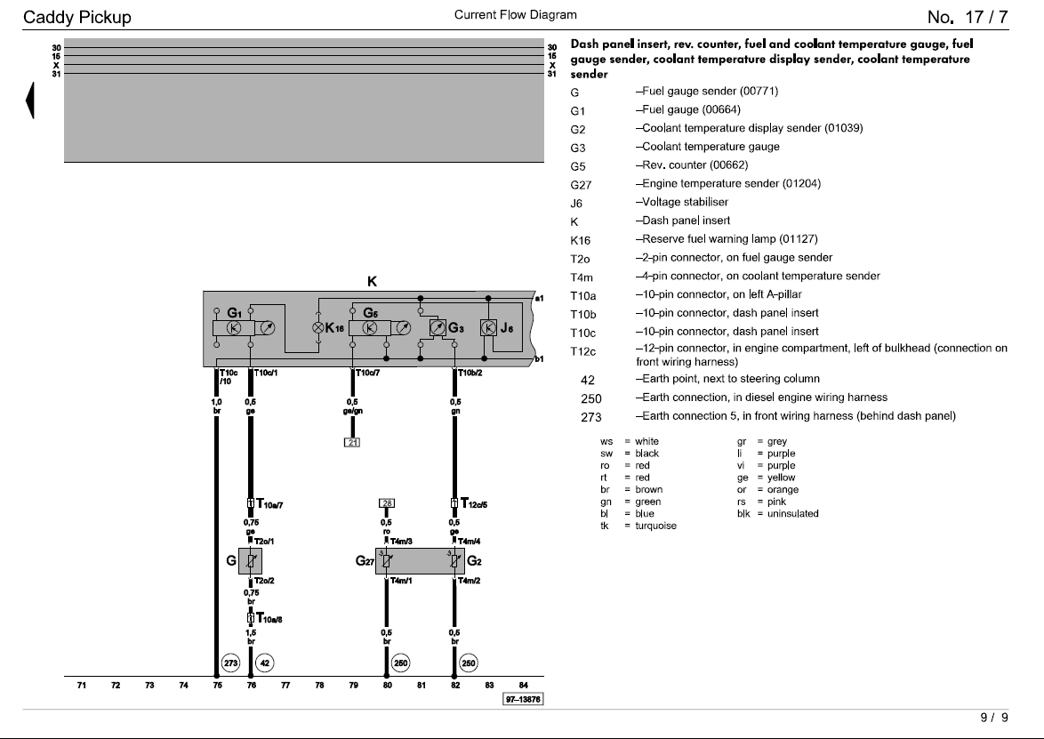

I have the wiring diagram for the instruments which indicates that the power supply for the fuel gauge is via a voltage stabiliser. My reading of the diagram is that this power then flows through the low fuel warning lamp (in series), then to the fuel gauge, then to the yellow wire which goes to the sender which then supplies varying degrees of earth resistance depending upon the float position. At empty the resistance becomes low enough to illuminate the warning lamp.
Do you have the diagram? This definitely isn't correct. The lamp cannot be operated directly by the float, because the current would be too high and the lamp would illuminate gradually instead of going off instantly.
Unfortunately I wasn't able to find schematics of the instrument panel, I only found information, that the gauge is operated through cluster of operational amplifiers in the LM2902N chip. Something like bad resistor can cause output to be stuck at full voltage, or the chip could be burned. Unfortunately I cannot say more without full schematic diagram.
The diagram I have is the attached pdf file which I downloaded from Erwin.
Hopefully you can open it?
Any thoughts greatly appreciated.
Caddy Dash Panel.pdf
My understanding is that the lamp is actually operated by the gauge and not directly by the float. However the float must regulate the resistance going through the gauge which in turn provides sufficient earth / ground to illuminate the lamp?

Managed to take a screenshot of the pdf.
Hopefully this will be accessible.

The diagram looks like the horrible grey and black things presented by VW, in the VAG-COM, VCDS legacy type, appeals more to computer types than non-computer types like me.

This is diagram for wiring, the functional blocks are extremely simplified, just to show basic function of the block.
Both gauge and lamp are operated by the operational amplifier chip. Combination of resistors and capacitors around it provides delay, that prevents oscillating of the needle because of fuel sloshing around, and signal for the lamp to go off once voltage gets below set threshold. The lamp also requires some transistor, because OA isn't able to drive a lightbulb directly.
Any open solder or burnt component can cause bad signal for the gaige. But it will be quite hard to pinpoint the root cause without the complete circuit diagram.
On 13/07/2025 at 13:12, Koponop said:
Although I've been chasing after the voltage stabiliser I have no confidence that it would provide the answer as I can measure 12v at both sides of the low warning lamp which would be correct for proper illumination. So I will eliminate the stabiliser as a suspect. I have already replaced the gauge itself but with the same result - always full. I am reading 7.93v at one side of the fuel gauge which coincides with one side of the temperature gauge. The same 7.93v also goes to the yellow wire for the sender so long as the sender is disconnected but this drops to 3.46v when the sender is connected, presumably due to the resistance within the sender.The other side of the fuel gauge reads 0.8v which appears quite low in comparison with the other side of the temperature gauge which reads about 5.5v when cold while dropping to about 4.5v as the engine warms and the hand rises. I now wonder if the low voltage on the other side of the fuel gauge is the cause of the hand reading full
12V at the both sides of the indicator lamp is correct - it's operated by a transistor, which typically connects load to the ground, as this type of transistor is cheaper and overall circuitry is simpler. Same case with the gauge. There should be an 8V stabiliser in the cluster, so 8V measured on gauges is correct. As with the lamp, it's likely that top of gauges is connected directly to the voltage input and a transistor is operated between ground and gauge - this can be the failure point, a transistor can fail and be stuck in shorted state.
Voltage drop on the yellow cable is indeed caused by sender's resistance and it's correct function - the voltage should correspondent with the fuel level.
