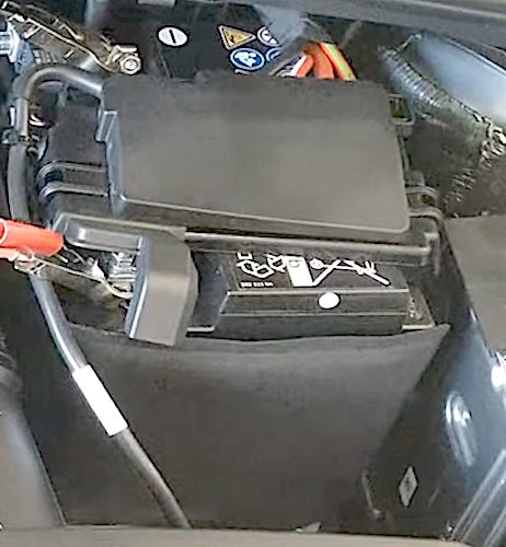

So i opened the engine bay to fill wssher fluid and found that a rat ate my battery insulation. Went to the garage and they said all wires seems intact and nothing to do, insulation not beed ina very hot xountry so i can just remove it, however i found this infront of the battery and i don't know if it is part of the car.
I also having gps issues but they claim car have no built in gps and it's inly from Android auto. Which is strange as my phone works fine the issue only occur when using navigation on the car itself, also it's ok sometimes
So what do you think? Is that red part of the car? Also how can i clean the pee and pop the rat left behind 🤦🏻‍♂️
'Thermo covers' are dual-purpose - they shield a car's starter-battery from high temperatures in the engine compartment and also provide (limited) protection against extreme cold weather.
This image is of the starter-battery fitted to a 2024 Israel-marketed Fabia Mk4 and shows the insulated cover surrounding the battery's sides.
My own 2024 UK-marketed Fabia Mk4's starter-battery does not this cover (though my 2009 Skoda Roomster's battery has a cover) but specifications can vary significantly from country to country.
(I don't know what the red thing in your photo is. It doesn't look like it is part of your car, but you might want to check whether the rat has also had a go at the sound-deadening pad fitted to the underside of the bonnet. You may need to have the engine compartment professionally valeted to get rid of the rat crap.)

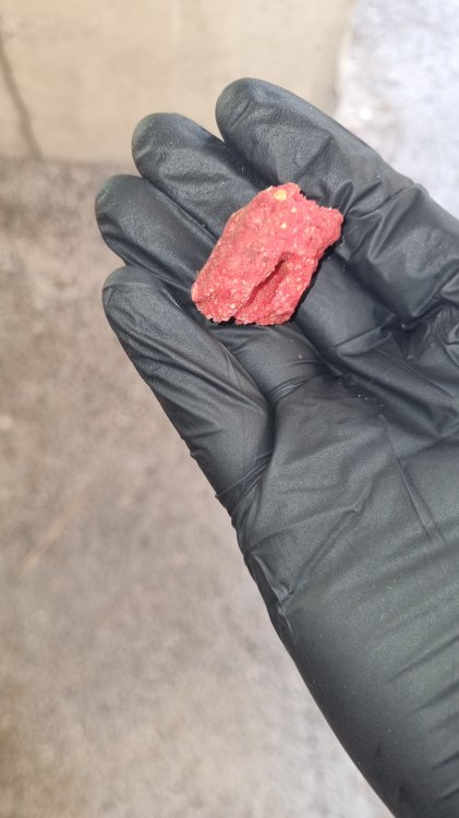

I went over to the garage, the importer one, and they had a quick look, it was the end of the day. they said that i can just remove the insulation and it should be fine.
the red stuff is rat poison, my best guess is that the rat picked it up somewhere and climbed into the engine bay as it was cozy for them.

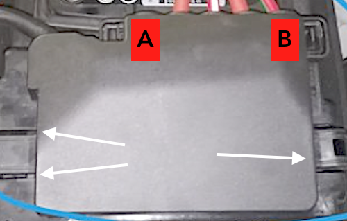

On the top of a Fabia Mk4's starter-battery the protective plastic cover over the terminal 'bus-bar' is clipped to a sub-frame beneath.
This photo of the cover shows two lever-type plastic clips (A and B)
and, if you look closely at the sides of the cover, you will see three small holes where I have arrowed. Short plastic stubs on the sub-frame fit into those holes when the cover is correctly attached to the battery.
After taking off the small plastic clip-on cover that protects the battery's positive terminal, the removal method I use is as follows:
Move Clip A sideways so that it frees up from the sub-frame (it will only move in one direction) and simultaneously pull the top-left corner of the cover firmly upwards. This should result in the two holes in the left side of the cover coming free from their stubs, leaving the cover loose. Now move Clip B sideways so that it frees up from the sub-frame and the cover is now completely off.
When replacing the cover, I begin by hooking the hole in the cover's right-hand side over its little stub. I then press the cover carefully downwards all around so that the two holes on the cover's left-hand side slide over their matching stubs on the sub-frame, and make sure that clips A and B lock properly in place.
(I've not attempted to remove the battery, so it's no good asking whether I know how to do that 🙂)

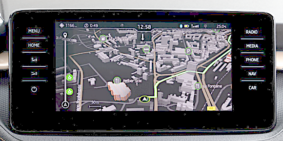

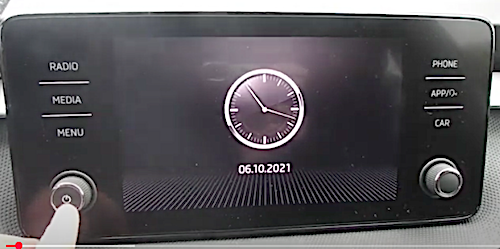

For the UK (and presumably everywhere else) there are three possible infotainment units that a Fabia Mk 4 may have. These are named "SWING", "BOLERO" or "AMUNDSEN", with Swing having the lowest specification, Bolero having a higher specification and Amundsen having the highest specification.
Swing and Bolero (photo below) both have a two genuine rotary knobs
whereas Amundsen (photo below) is a pure 'touchscreen' unit and has no knobs.
For a Fabia Mk4 to have an inbuilt sat-nav navigation capability, it must have the Amundsen unit and this feature is visually apparent from the Amundsen unit having a specific NAV 'button' on its right-hand side (above the CAR button).

Thank you, i have the one qith the knobs 9"

The infotainment unit's size depends on how you measure it.
You could post a photo, but, as your car's infotainment unit has knobs, then it is either a SWING or a BOLERO and neither of those has an inbuilt navigation capability.
When you connect your phone to the car and use Android Auto, the maps/ routes/speed limits that display on the infotainment unit's screen will come from your phone and depend on whatever navigation app you have chosen to run on your phone.
There are navigation apps (eg SYGIC) that have a traffic-sign recognition feature, but I've no idea how these react if the road being driven on does not appear in the app's mapping data and has no speed-limit signs.
