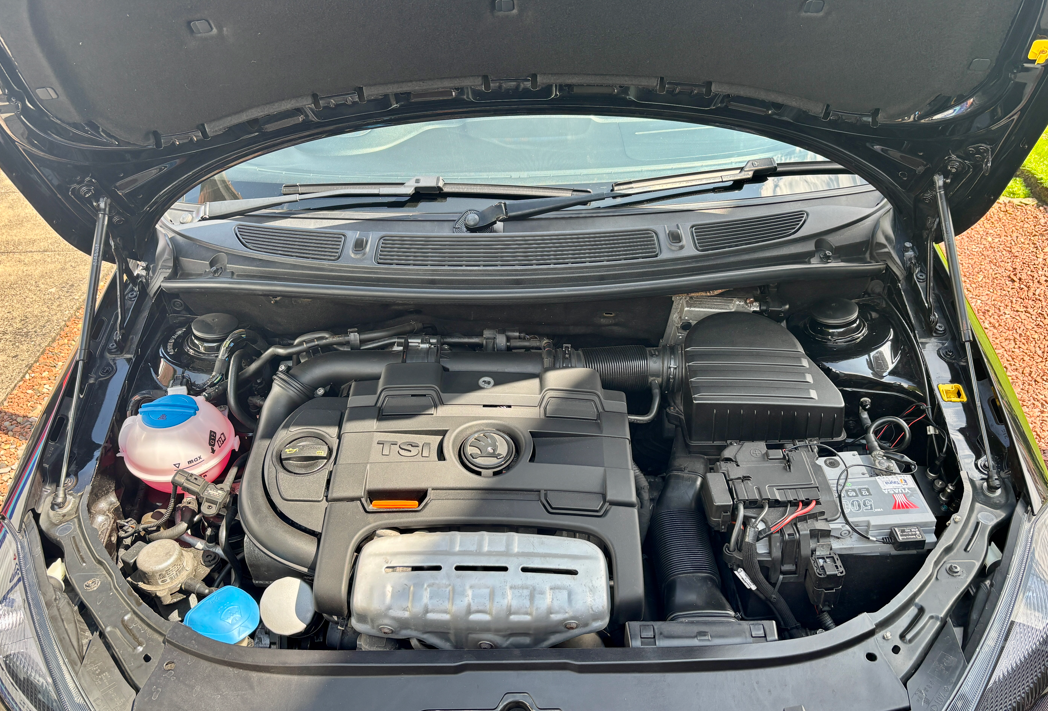

Had undertray off today, no sign of a radiator drain and lower hose is all but inaccessible, replaced the expansion tank but will be taking the Scabia to my indi to drain flush and renew. violet/red antifreeze and distilled water.

Yes it was a case of lifting car, removing intercooler pipe (blocking off intercooler so it didn't get drained coolant in it),
bottom radiator hose off followed by flushing a number of times with hosepipe and pressurising with compressed air to purge as much as possible.

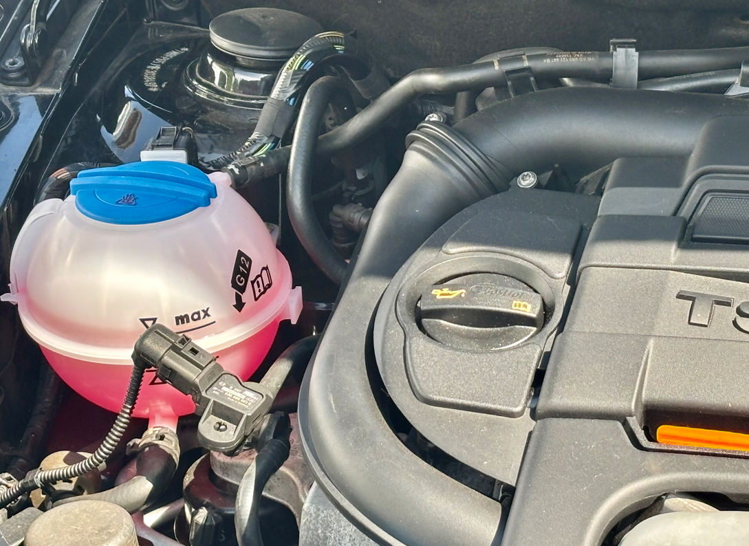

Finally slowly refilling the system with 50% "violet" antifreeze and distilled water, took the opportunity at the same time to fit a new coolant expansion tank
After using various dedicated outlets, temp sensor ports and removed hoses to flush coolant on my 1.9 / 2.5 / 2.0 diesels over the 23+ years of ownership of various Skodas, I have always found the process messy and adding risk of leaks, especially from radiator drain valve if/when there is one.
So what I have been doing for the past 10 years, is to vacuum out coolant via hoses going to the expansion tank (using a Sealey TP69 vacuum extractor I have been using for 15+ years of oil / coolant / brake fluid / PS fluid changes ). At least both hoses are visible in case of leaks. If you keep vacuum there, e.g. on the tank while blocking off the return hose, no further leaks will happen when removing water pump. For refilling, I keep vacuum on the return hose, and add fluid to the reservoir.
But outside timing belt / water pump changes, I tend not to flush the whole coolant, just drain then replenish the transparent reservoir at least once a year with G12+/++. This keeps silicates content high (silica bag removed years ago of course), so the water pump is happy, and the coolant clean. No problems with this method for the last 6 years on both vRS and the Roomster.
