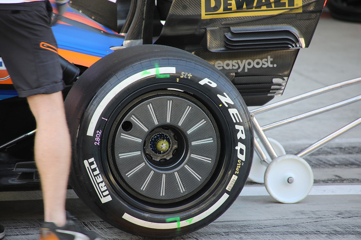

I think this 2024 F1 wheel settles the debate, really. For performance and nothing else, a lighter, smaller wheel paired to a tyre with a nice rigid carcass, is the best.
Aside from brake clearance, it is indeed all to do with looks (as per my thread). As soon as you go up in sizing, you're increasing the unsprung weight and cost, while decreasing the ride quality. There's a reason brands like BMW spec a staggered 19"/20" setup on some performance/track orientated M cars.
I'm not saying cars should have 15" wheels. Especially on larger cars, this would look silly. I'm just saying that, realistically, you want to be at a 35 profile, at a minimum. Of course, this applies more to larger wheels - at 18" or so, a 40 profile is the sweet spot, really.
You've lost me, I'm all for smaller wheels and narrower tyres. Those in the photo don't look small to me. 15" wheels would only look silly because the designers fashion the ca's side view for larger wheels and for the wheels to fill the arches, very impractical in some instances particularly in some places.
