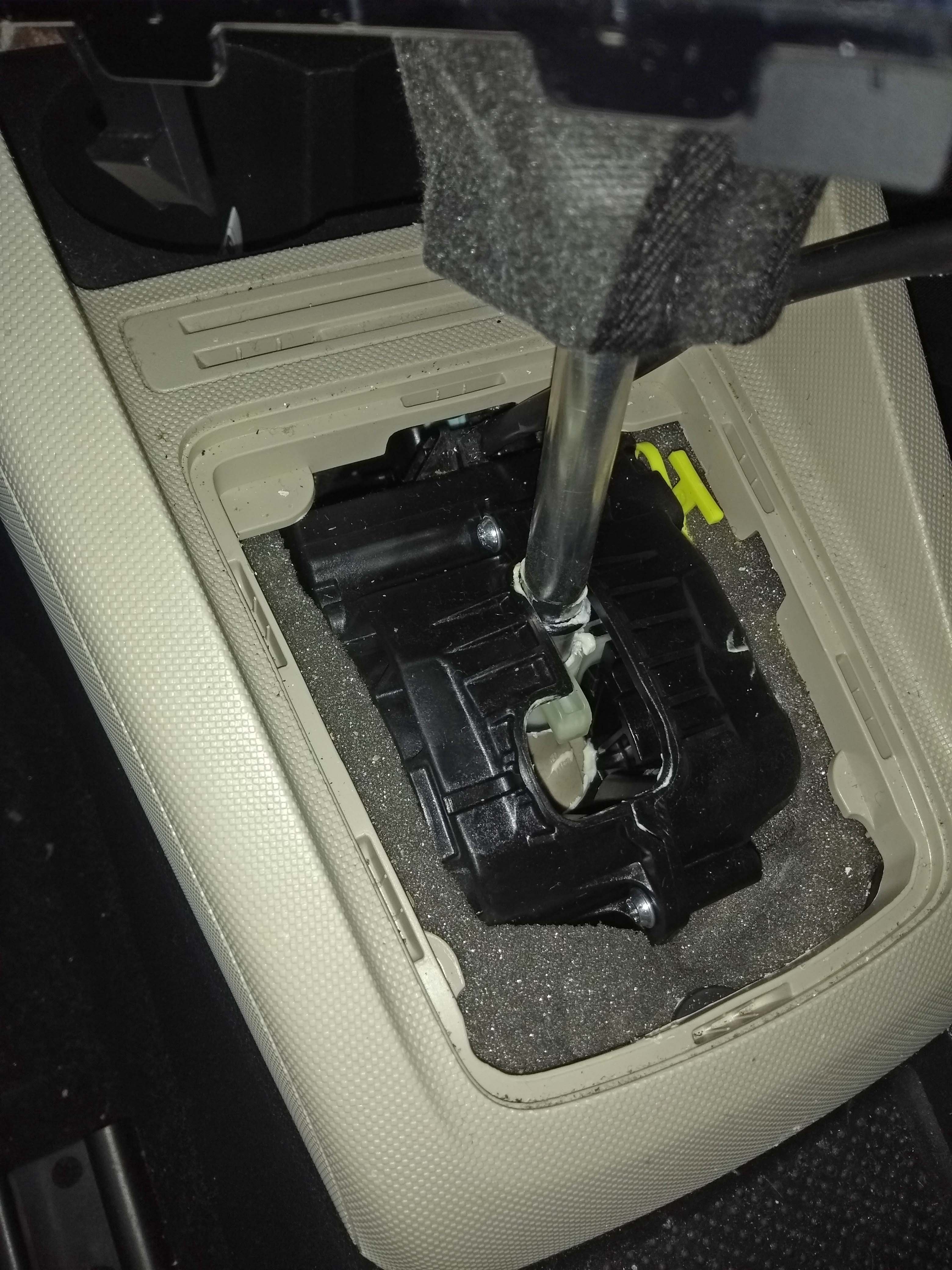

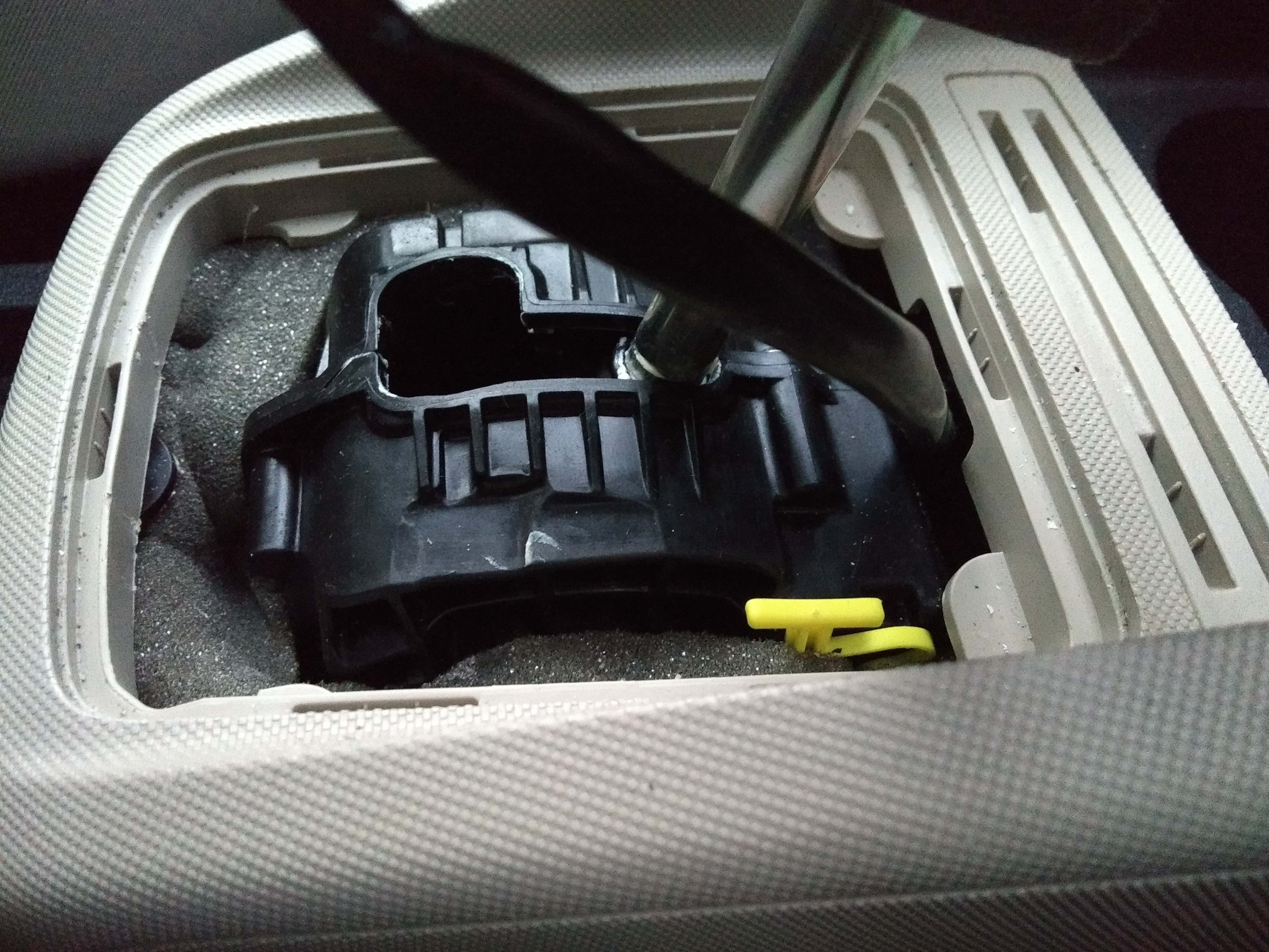

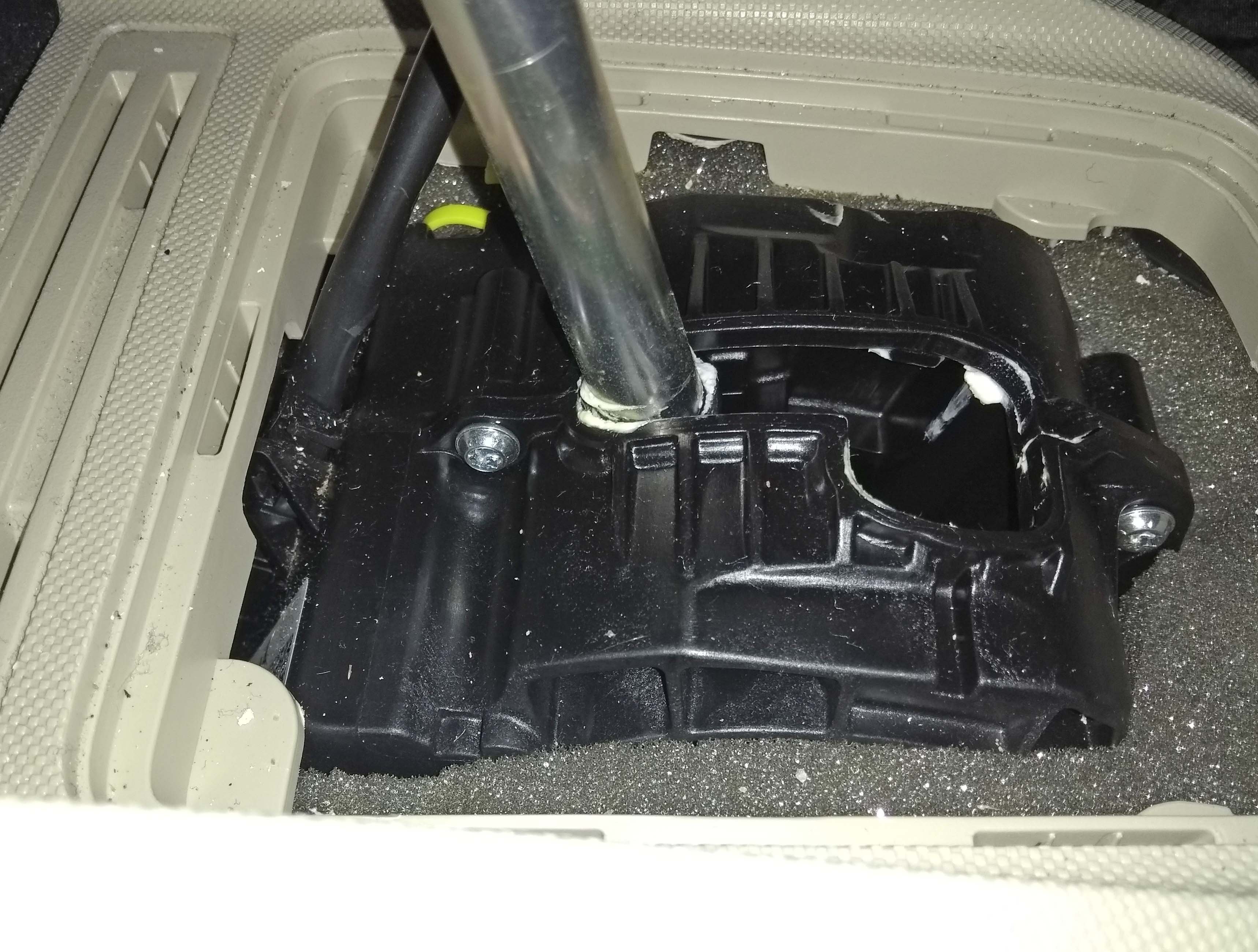

    I've dug the gaiter off mine again, photographed the selector (see attached - which looks identical to the one in the YouTube video I linked to earlier in this thread as far as I can see), and sent th

    In the absense of any corroboration on the need to modify the switch, I decided after measuring again and using a bit of Blue Tac, that it was fouling where I thought it was as per previous photos. S

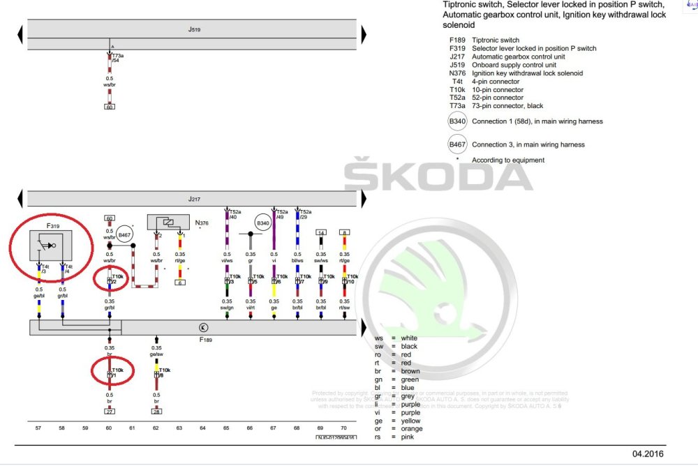

I have the same problem with my Monte Carlo. DQ200, 7 speed. I already got the gear shift lever unit replaced ( 2nd hand part, driven 26t km.) It started to give error after three months. Error! Workshop!. Blaaa, blaa blaa...
The notification comes very briefly while driving with alarm beeb. Maybe 2-3 seconds and dissapers. There is a fault code found with VCDS, B1162 29 - Signal Implausible, Intermittent - Confirmed
I've done some research: in my case my gear shift lever part number is 6C1 713 025 AA and the repair kits are available only for the levers with number 3Q0, 5Q0 and 5Q1.
In this case the only solution is to tear down the whole unit and solder out the old microswitch and replace with new one.

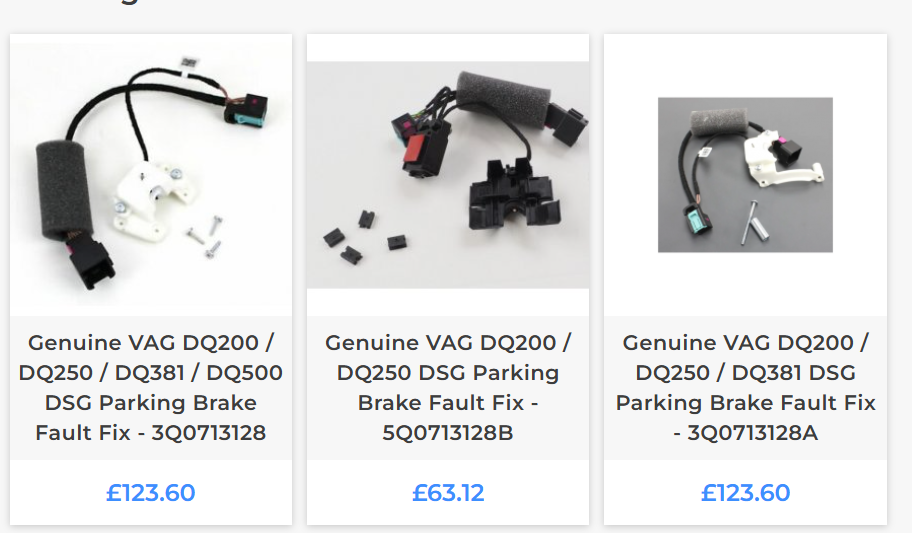

Not sure what part number ours is yet other than it being a black top from getting the gaiter off - but what I have found from a company called AKS Tuning's website is there are four different kits to fix the issue. It's also clear from this forum that some people with Fabias have had a fix done at a relatively sensible price which I assume didn't involve stripping the selector down to dig the problem microswitch out or the labour charge would have been much higher. Also, if Skoda were getting hit with warranty claims all over the place, that's an incentive for VAG to come up with an easy fit solution for all the affected selectors in all the affected VAG ranges.
AKS tuning list the following:
5Q0713128A black selector top
5Q0713128B black selector top
3Q0713128A white selector top
3Q0713128B white selector top
I was planning on digging the gaiter off again in the next few days and sending AKS Tuning a photo and see what they say about mine.

Just found this on YouTube that suggests one of the switch kits might well fit the Fabia, eventhough I found a listing on LLL Parts for the kit which mentions the Octavia as the only Skoda in the fitment table.
https://www.lllparts.co.uk/product/5q0713128a/micro-switch-5q0713128a

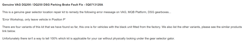

I believe it was this one or similar. Indy said there was a choice of two and they wouldn't know which one until stripped.
AKS tuning
No image preview
Genuine VAG DQ200 / DQ250 DSG Parking Brake Fault Fix - 5...
Genuine repair kit for fault 'Error Workshop, only leave vehicle in Position P'

I've dug the gaiter off mine again, photographed the selector (see attached - which looks identical to the one in the YouTube video I linked to earlier in this thread as far as I can see), and sent the photos to AKS Tuning who advise me that 5Q0713128A is correct for it, so I have ordered one just a few minutes ago.
I'll document the arm rest and console removal when I try and fit it which will be some time next week, and @jtmattila I will confirm the part number on my selector so we can see if it's the same as yours.
In case you don't know and ever need it, that yellow thing (bit of wunderbar VW fantastic-plastic) is for if the lever gets stuck in 'Park'
Definately worth knowing, but if you've ever wondered why it is so difficult to get to those levers on autos, it's because the most likely cause of the box refusing to come out of Park is if your brake switch has failed, which means you don't have any brake lights and shouldn't be driving it. So it's really only for recovery/garage purposes.
