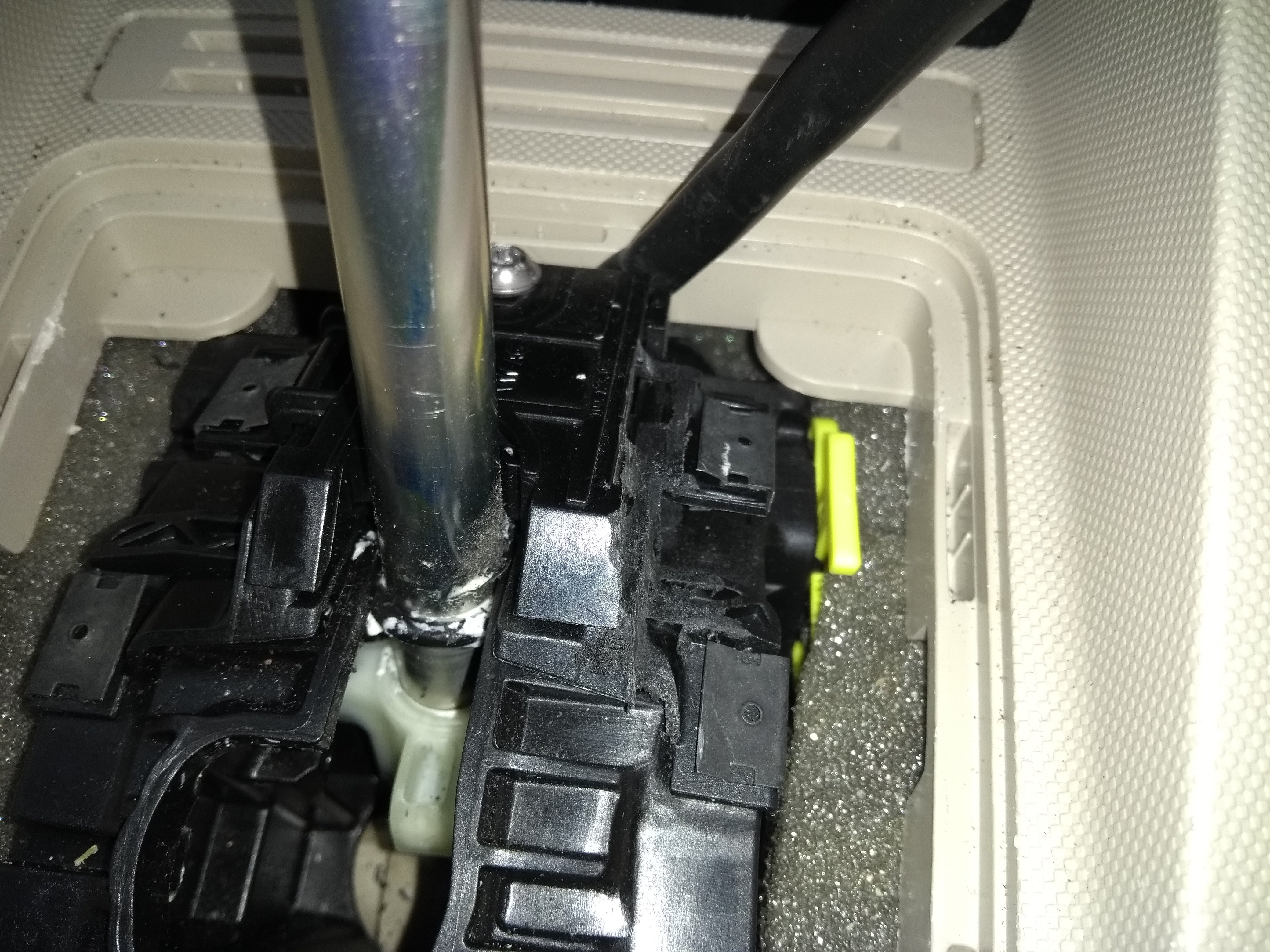

    I've dug the gaiter off mine again, photographed the selector (see attached - which looks identical to the one in the YouTube video I linked to earlier in this thread as far as I can see), and sent th

    In the absense of any corroboration on the need to modify the switch, I decided after measuring again and using a bit of Blue Tac, that it was fouling where I thought it was as per previous photos. S

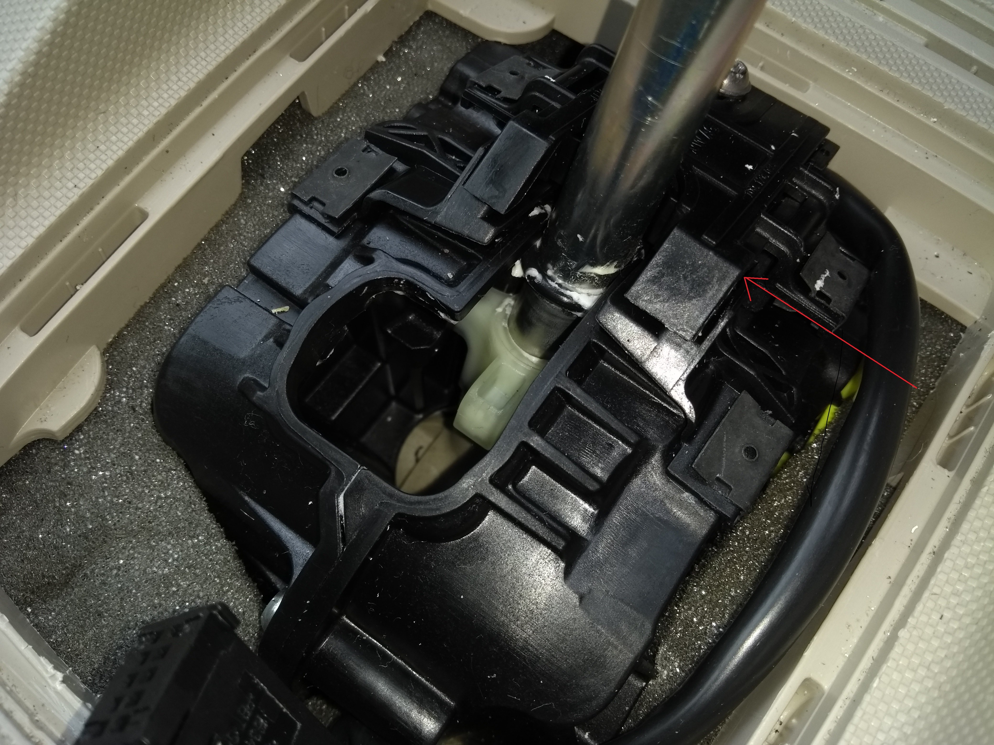

@jtmattila Just a quick update. Got my console out last night and I can confirm my selector is 6C2 713 025 AA. i.e. your 6C1 713 025 AA would appear to be the left hand drive version of the same selector. I ran out of light so I'm going to have a go at fitting the switch kit this morning all being well.

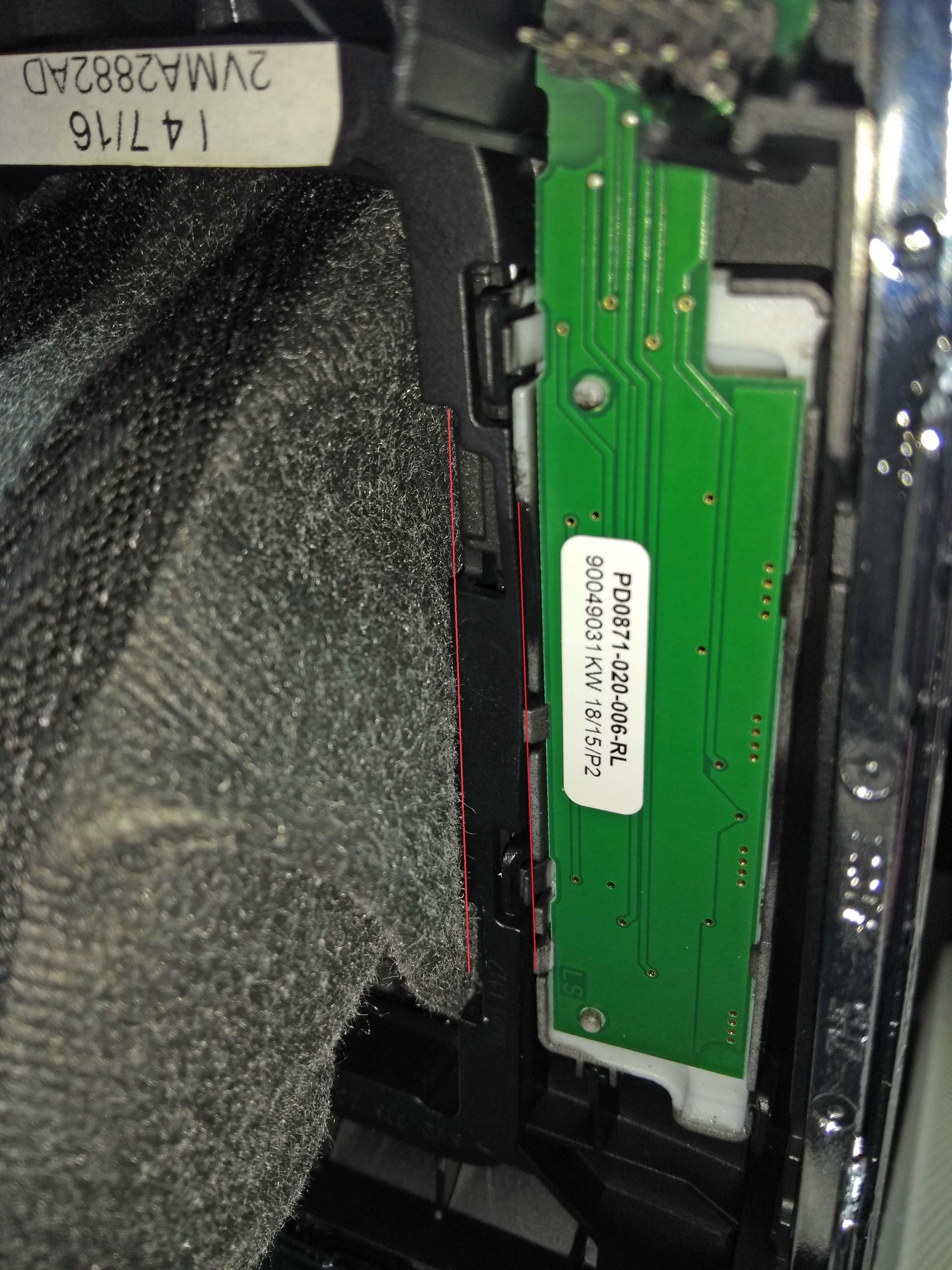

Got the 5Q0 713 128 A switch fitted to our Fabia and it seems to work fine. Refitted console - fine. BUT the gaiter/plate is refusing to clip back on. Through a bit of measuring and feel, it seems to me that one shoulder of the new switch that sticks up fairly high (arrow in red in my photo) and is wider than the same bit of plastic on the other side might just be fouling the underside of the selector plate by a few mm on the side where the gear indicator PCB is.
i.e. the underside of the plate feels as if the area I have marked with two red lines is pivoting over the bit of black plastic show with the red arrow.

Certainly don't want to start hacking mine about until I'm more certain it can be made to fit. Off to find some BlueTac now, to see if I can impression where parts might be making contact........

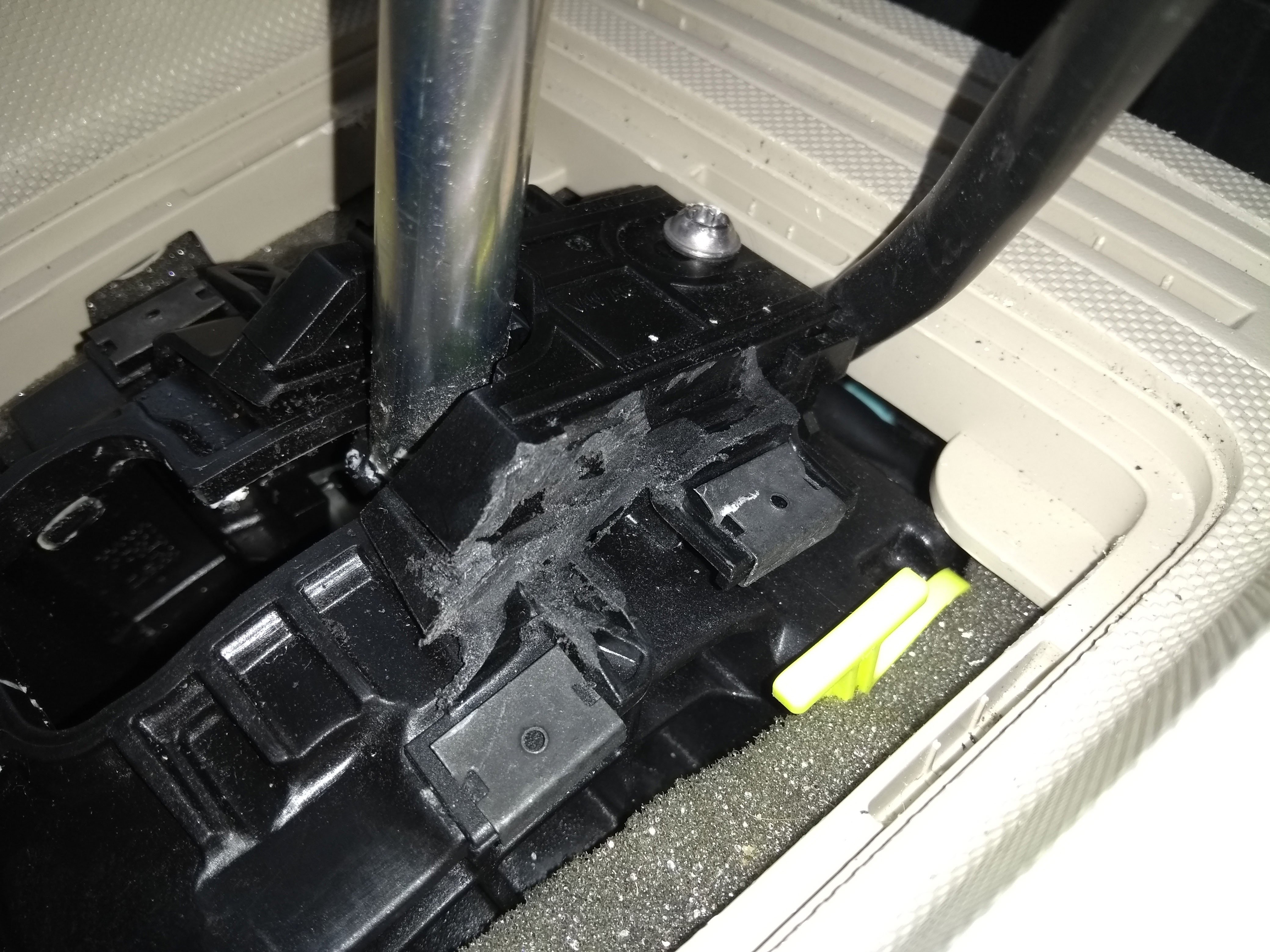

In the absense of any corroboration on the need to modify the switch, I decided after measuring again and using a bit of Blue Tac, that it was fouling where I thought it was as per previous photos. So I taped up the selector to stop any bits of plastic going in, took a deep breath, and ran the tip of my power file across the R/H side of the switch to take some of the plastic off. I have to say that I ended up taking more off than I was comfortable with to get the gaiter plate to fit - almost down to the two securing tabs (removing some of the reinforcing plastic above them). However, the switch plate still feels as secure as it did before.

So to sum up, whilst this has been a success, if anyone wants to attempt it themselves, they do so at their own risk. The part isn't cheap and you can't exactly return it when you have hacked lumps out of it as I had to do.

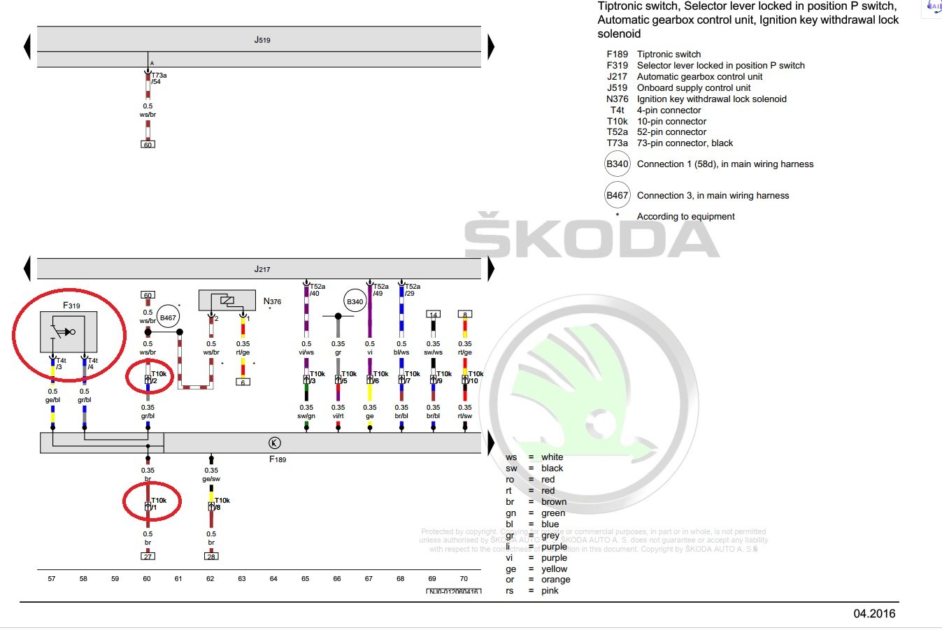

@jtmattila Looking at the diagram, J217 is the the gearbox control unit under the bonnet. So the multiway connector that you unplug from the front of the selector would be T10k, and I assume the "Tiptronic Switch" F189 is some sort of control unit within the selector.
It looks like F319 is the faulty switch - and it appears to be a separate unit on its own pair of wires, though I can't yet find any evidence it is available to buy on its own. Then again, it could simply be a casing around an industry standard microswitch.
T10k/1 seems to be ground. T10k/2 seems to be the switch output - both circled in red.
So, if the selector lever can be moved with the unit off the car (i.e. it doesn't require power to the selector unit to unlock the lever), it seems possible the unit can be tested by measuring the resistance between pins 1 and 2 with the lever moved out of Park. The only issue I can see with that is we know the fault is very intermittent, so there is no guarantee that you would actually pick the fault up at the time you test (you'd just have to hope that there is a higher than normal resistance present all the time, and it just gets worse when the fault actually occurs).
I found a diagram on the net of the T10k connector plug pin out so that is below so you can work on the pins on the selector socket.

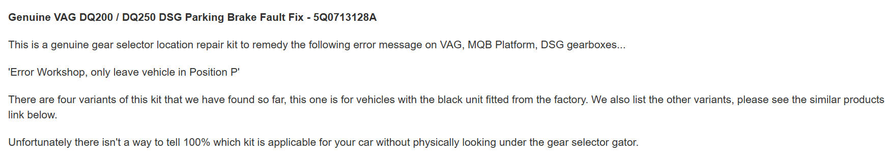

The place selling kits earlier in the thread now offer four varients.
AKS tuning
No image preview
Genuine VAG DQ200 / DQ250 DSG Parking Brake Fault Fix - 5...
Genuine repair kit for fault 'Error Workshop, only leave vehicle in Position P'
@logiclee Yes, they always did sell four variants. 5Q0 713 128B is listed for the Skoda Kodiaq. It is difficult to be certain from the pictures but the switch plate on that kit might well have the same issue, and you'd assume that if it also fitted the Fabia, websites selling it might be keen to communicate that out as it means more sales! I'd also expect my local indy to know about it if that kit fitted - but they told me they swap the entire selector on Fabias if they hit the fault.
We can ignore the 3Q0713128 and 3Q0713128A as those are for different selector units entirely.
