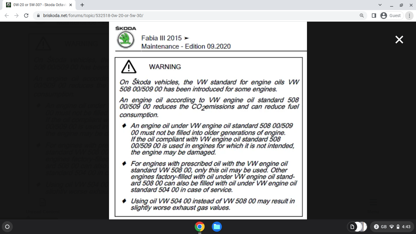

The VW recommended oil is 0w 20 FS IV. That is VW508 00 / 509 00.
Not VW504 00 / 507 00, 0w 30 FS III or 5w 30 FS III

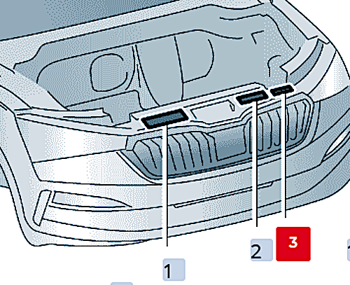

Under your car's bonnet will be a label indicating the recommended engine oil specification. The position of the label is marked  3  in the drawing below.
and - for my 2024 Fabia 1.0litre TSI motor with DCT - the information on that label is (as Ootohere has said)
VW 508 00
VW 509 00
SAE 0W-20

I stand to be corrected, but If you are uncomfortable with the 0w-20 508/509 oil spec, my understanding is that this new grade was introduced purely to achieve slightly lower emissions - and it is permissible to use the previous VW504/507 oil standard if wished.

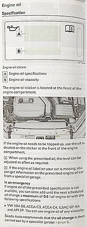

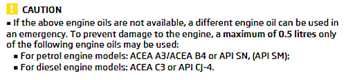

This is an extract from my 2024 Fabia Mk4's Owner's Manual
It will be seen that (as Ootohere advised earlier) oil to VW 504 00 standard is only acceptable for interim topping-up (maximum quantity 0.5 litres) when the prescribed specification of oil (VW 580 00/VW 590 00 for my Fabia Mk 4) is unavailable.

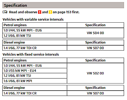

The Owner's Manual for a 2015 Fabia Mk 3 includes the following oil-related guidance.
Unlike my Fabia Mk4 car, my 2009 Skoda Roomster does not have an oil-label in the engine compartment, with oil information being provided in its Owner's Manual. As the Manual for a Fabia Mk 3 does not mention an engine compartment oil-label, I assume there isn't one.

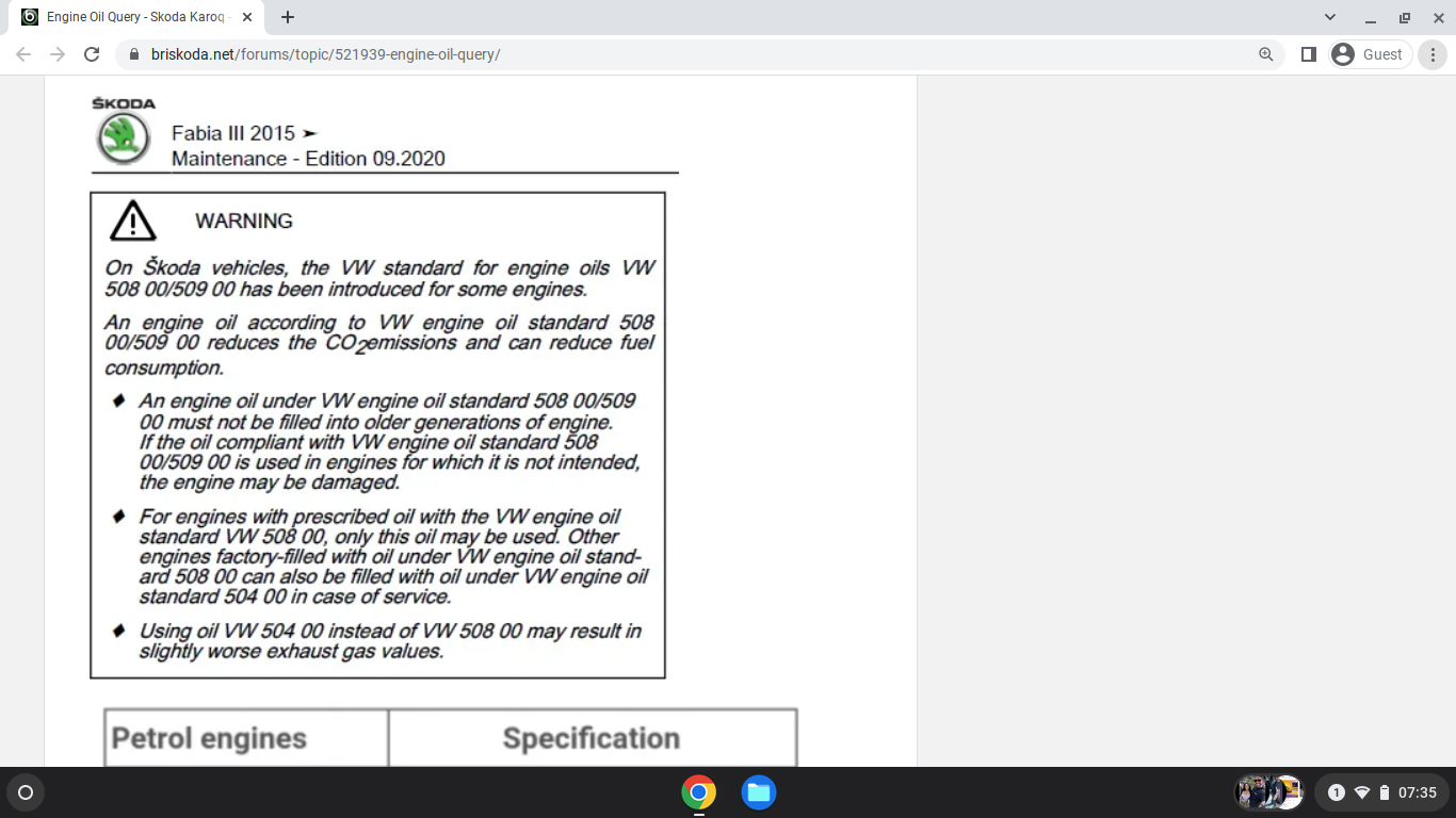

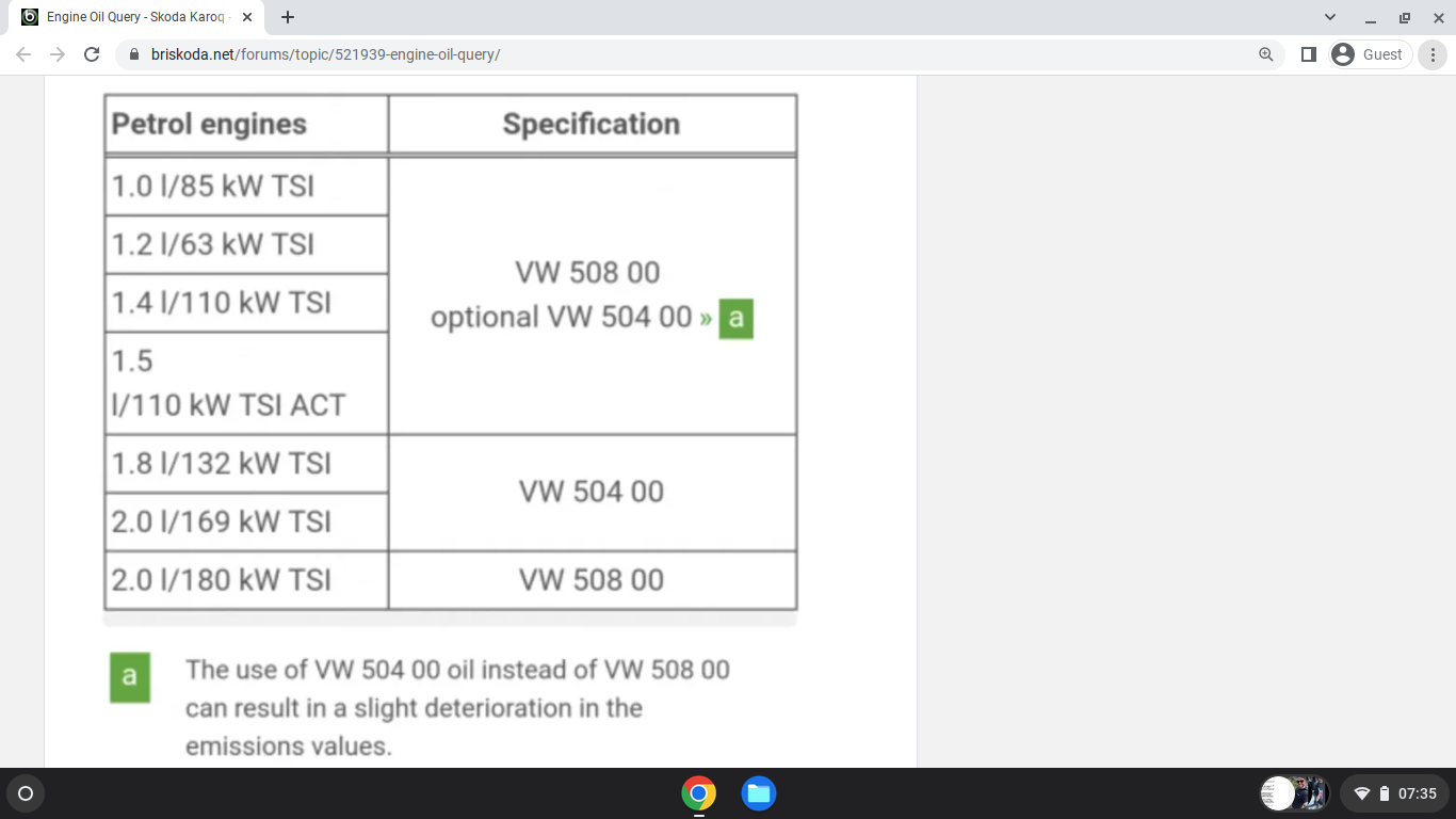

The Mk3 Fabia Owners manual from 2014/15 was 2-3 years before the 1.0 TSI & 1.0 TSI with GPF were launched and VW / Skoda went to 0w 20 FS IV at te factory pre WLTP / RDE 2 certification.

So what would be Skoda's recommendation for the viscosity of an oil suitable for a Fabia Mk3 built in 2015?
You could not predict the future. So it was as they came from Euro 5 into Euro 6. / 6d temp.
1.2 TSI,s. Or 1.4 TDI.s
They were saying VW504 00 / 507 00, so 5w 30 FS III.
Fixed or Variable Servicing.
But Fixed Servicing only was and is VW502 00, 5w 40 FS. But just for TSI,s. If you wanted.
But they never showed that.
