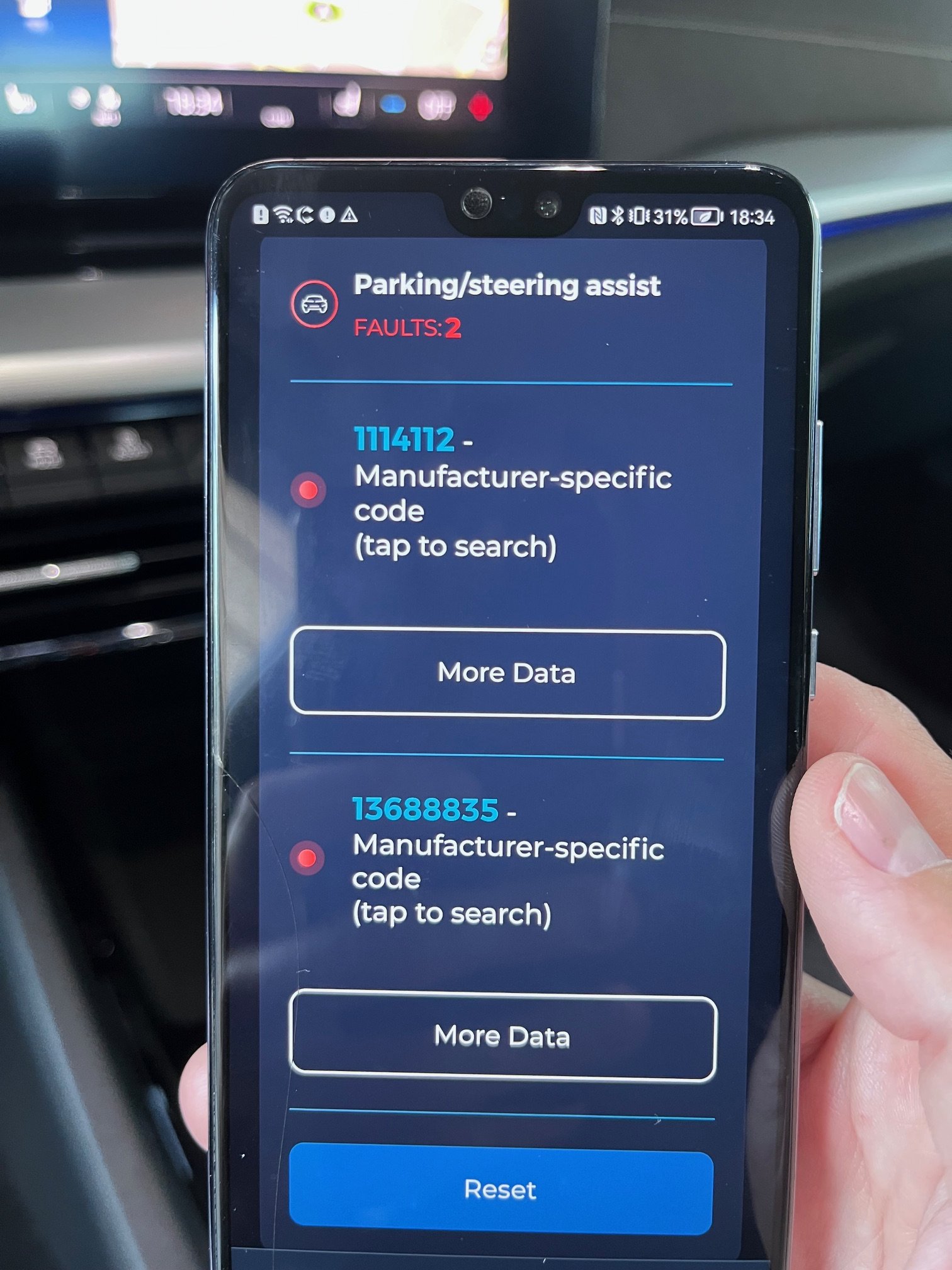

I have another problem with the PDC parktronic system, I don't know if it's a coincidence but when I wash the car and I get two errors for the parktronics at the back and the manoeuvring system! The error stays for a few days then disappears by itself...
I will upload a picture of the errors I read with Carista app for the PDC, for the media I have no error.

For the first problem, update the radio system. For the PDC problem, it sounds like water is getting in.
@Cairus Thank you!
I also thought of the option of water seeping in, but where, how...
All the sensors seem visibly ok, very strange.
