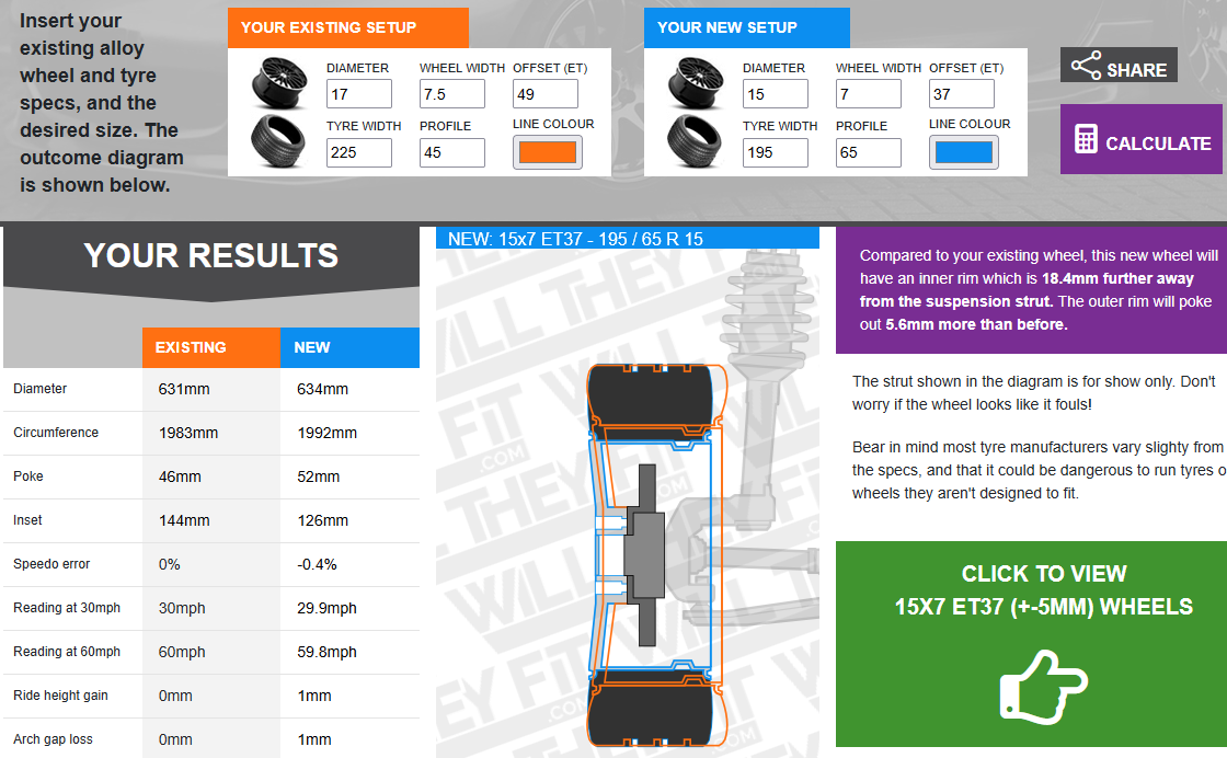

Here's some simulations i did on "Will it fit?":
Biggest OE wheel (7.5Jx17 ET49) vs 7Jx15 ET37:

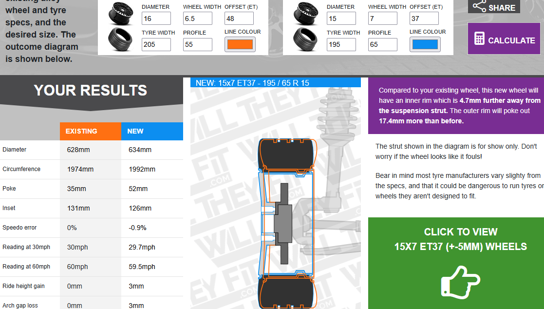

Most inset and widest OE 16" wheel (6.5Jx16 ET48) vs 7Jx15 ET37:

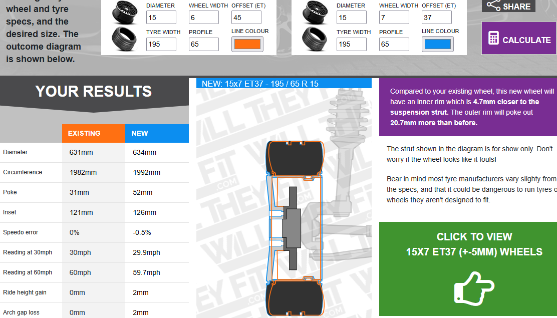

Pokiest OE 6Jx15 ET41 wheel vs 7Jx15 ET37:
