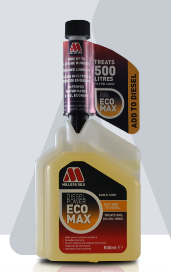

Fill the car up with good quality fuel and some injector cleaner.
Fill the car with people and luggage. Go for a good drive on a road where you can get the revs up, ideally with a good uphill run so you're working the car hard.
See what the smoke situation is during and after the drive.
If it doesn't help at all, do what @Warrior193 suggested.
A good hot work-out under load can do smokey diesels the world of good.
This is good stuff, but other products are available.
