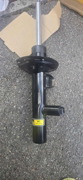

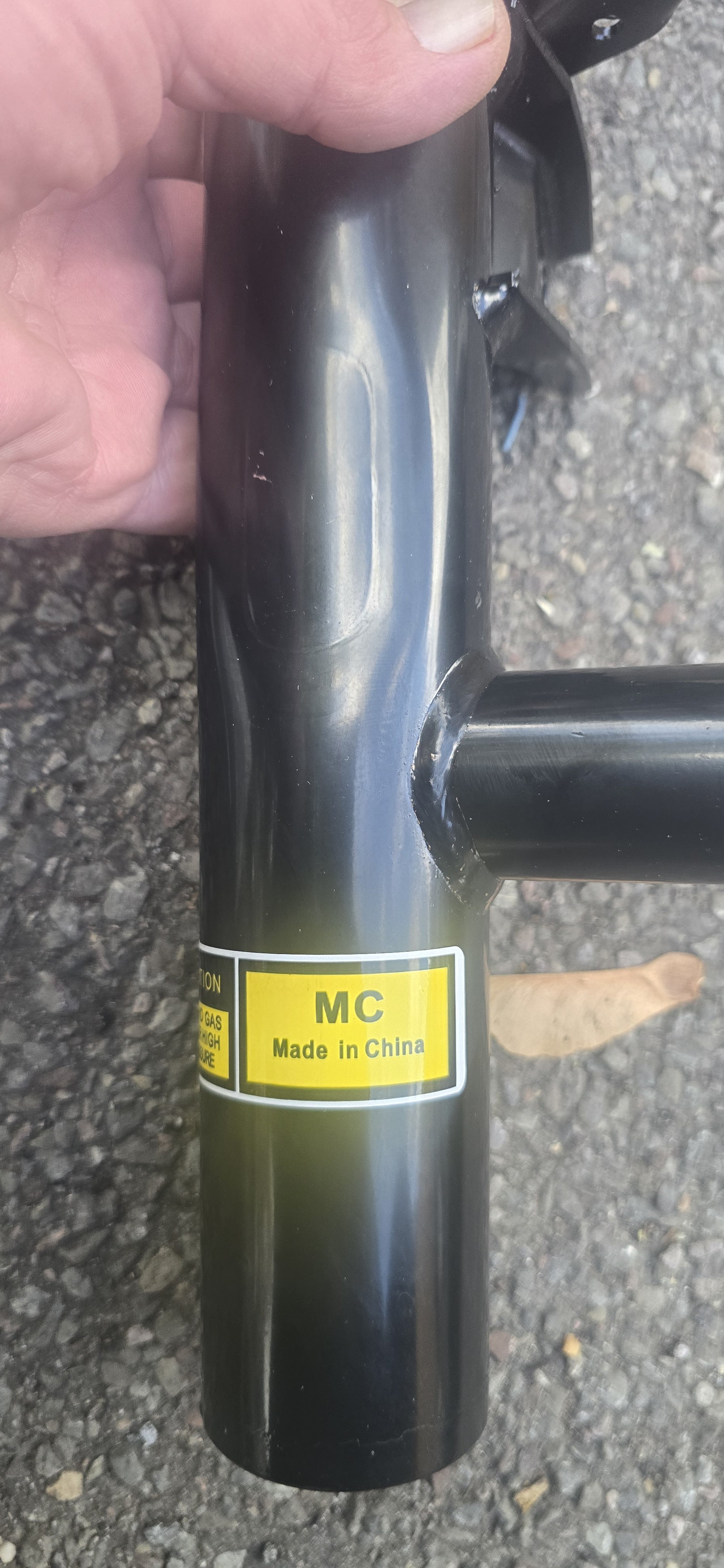

Because the financial situation , I bought 2 front shock abs from ebay, new, but...made in china with 100£ 😀🤣, oooo my God, lets see how long will work, this can be an experiment, keep in touch! Please don't laught, I'm curios about how they will.work.
Well you can only try but generally price reflects quality.
I would also get OE top mounts and bearings. These go at the top of the shock and allow it to twist as you steer.

Yes, I Know buy I will see whats happend.Many thanks.
