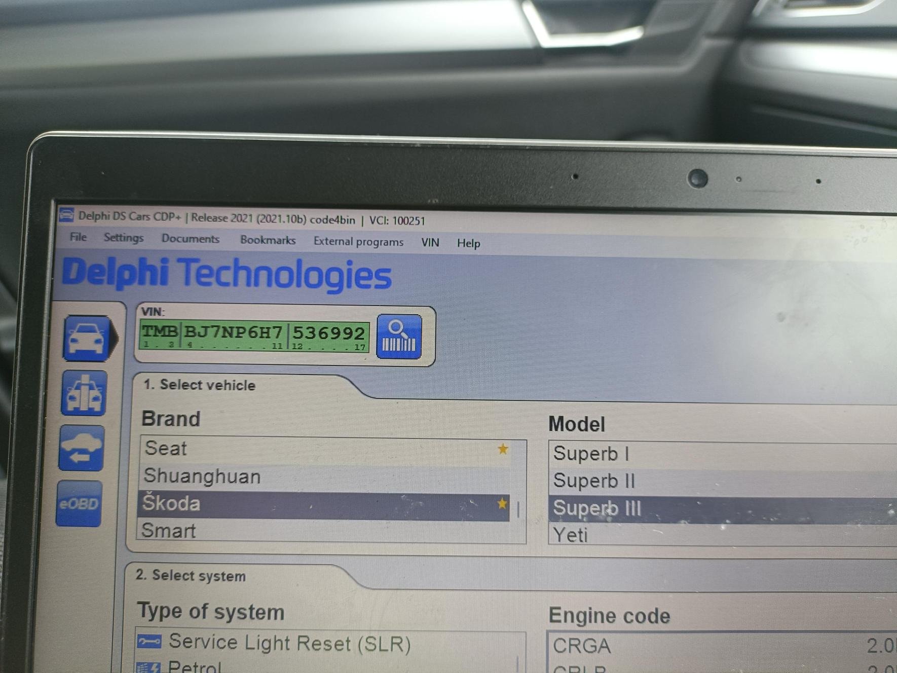

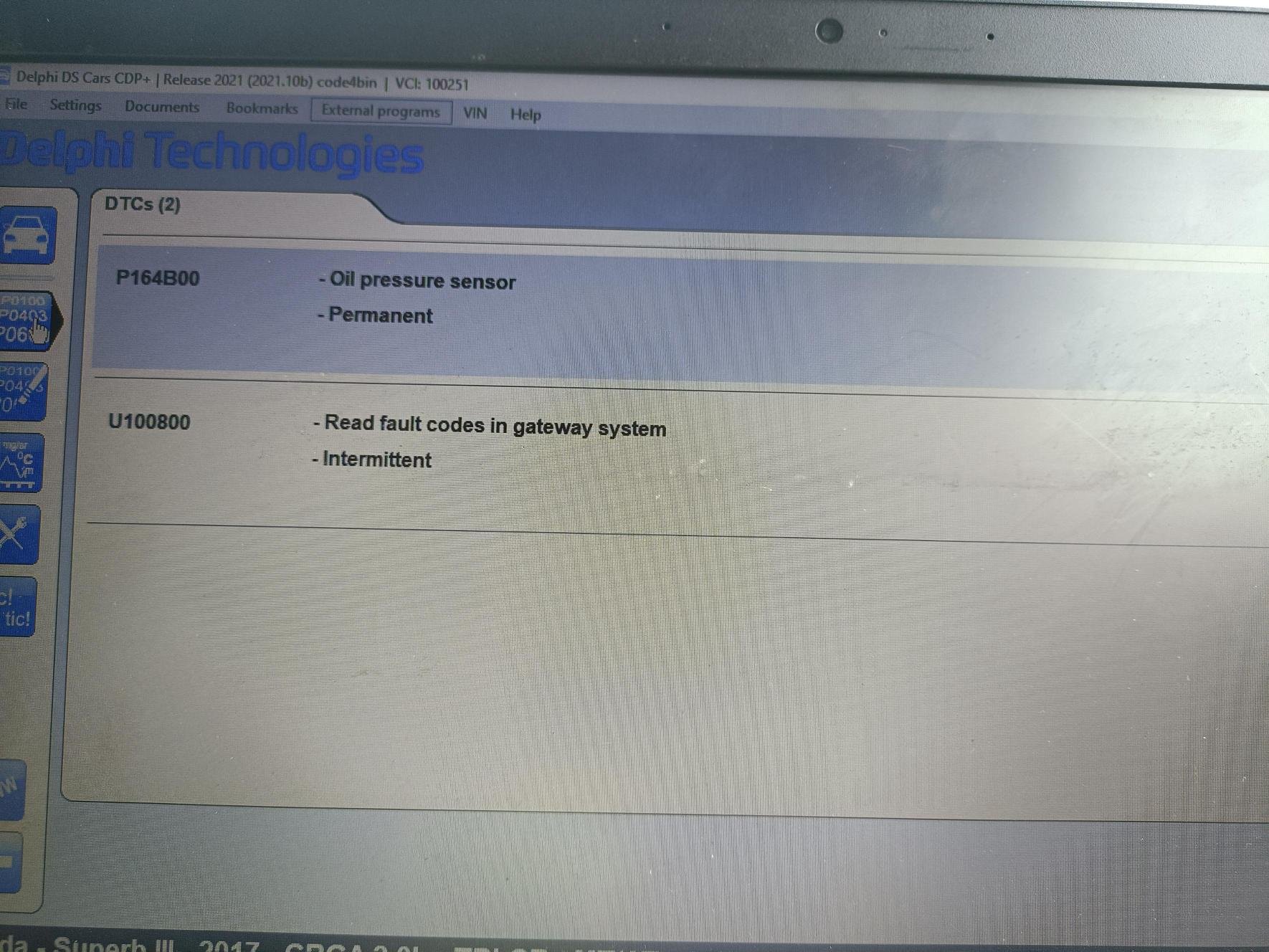

Finally got round to having the codes read. See images...
My mate did suggest a message about it being 247 miles since an high oil warning (I think that's what he said).
He's reset it.
I have had the same issue 2 more times since I posted, both times within 10 mins of me starting (so cold).
Mate suggested changing the oil pressure valve...
Thanks for any advice!
