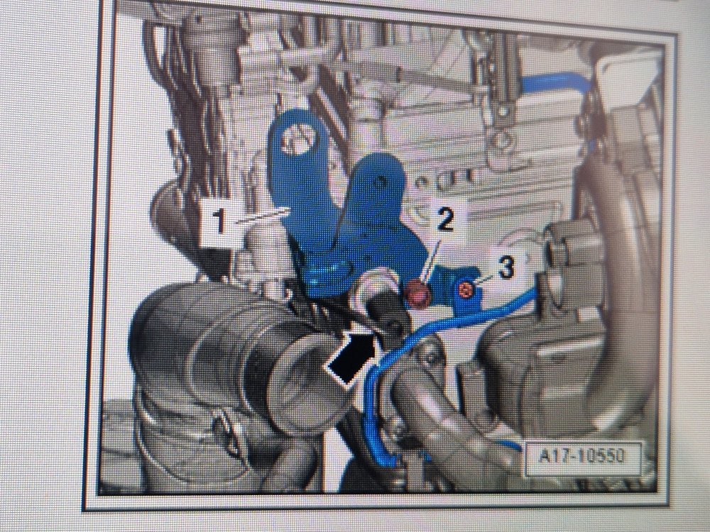

Have another look in the position shown in that second video I posted. I'm pretty sure that's where the switch is, very adjacent to the engine lifting bracket at gearbox end of engine head. You'll need to remove some air pipework for visibility and access.
Great picture! Thankyou!

I found it , however it is at the back and beyond my capabilities and tools.
Have correct ring spanner but as mentioned above looks like that bracket has to come off first.

Looking at the diagram , is it only 2 Trx bolts to remove bracket?
