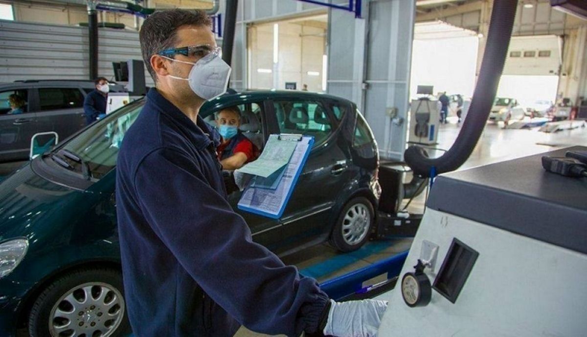

The Spanish automotive press "Autopista.es" (which has a bad habit of using lots of empty words and maybe/couldbe scare tactics to get people to read articles that in the end don't matter) posted this article warning that, depending on how national car safety equipment compliance regulations are interpreted, "millions of cars" may no longer be able to pass annual(-ish) technical inspections (e.g. "ITV" in Spain, "TÜV" in Germany) once the mobile carriers put the final nails in the coffin of 2G signals, because "Cars homologated from 2018" were required to include "eCall", and many cars' eCall function has 2G-only hardware:
Autopista
No image preview
Millones de coches pueden suspender pronto la ITV por un...
El apagón y la interrupción de las redes 2G va a paralizar el sistema eCall de muchos vehículos, y recordamos que es obligatorio ya en coches nuevos por norm...
