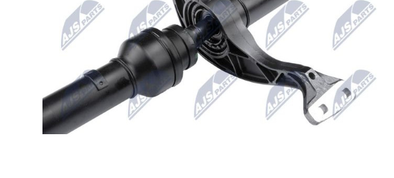

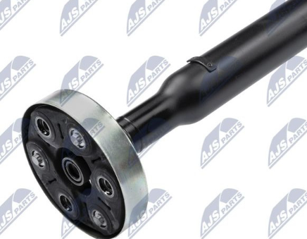

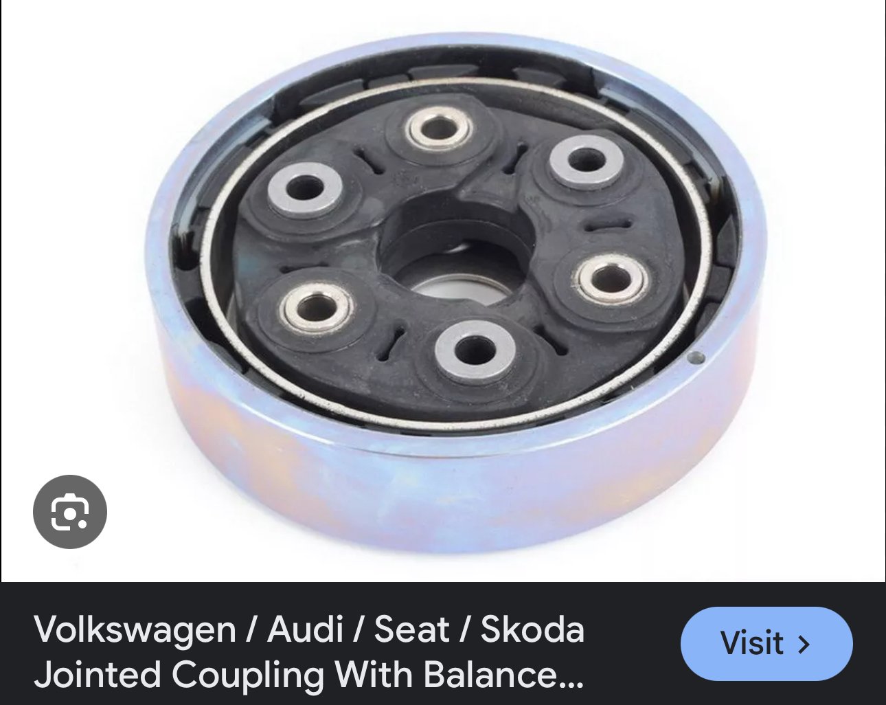

Thank you very much! where exactly are these balancing weights located or if you can give me a sample picture, I would be very grateful!
Is this?
That's the coupler with rubber dampers - no - along the prop or cardon shaft, there will be long thin weights that are usually bonded on, but these can come off (usually because something hit the shaft). It will require either identifying the weight that has dropped off and reapplying a new weight - or getting the shaft professionally weighed and balanced by a specialist. Most Skoda garages and VAG specialists can help here.
I understand, thank you, I'll look into this. Maybe they're some kind of weights like the ones in the pictures. Hopefully this works out! Thanks again!
