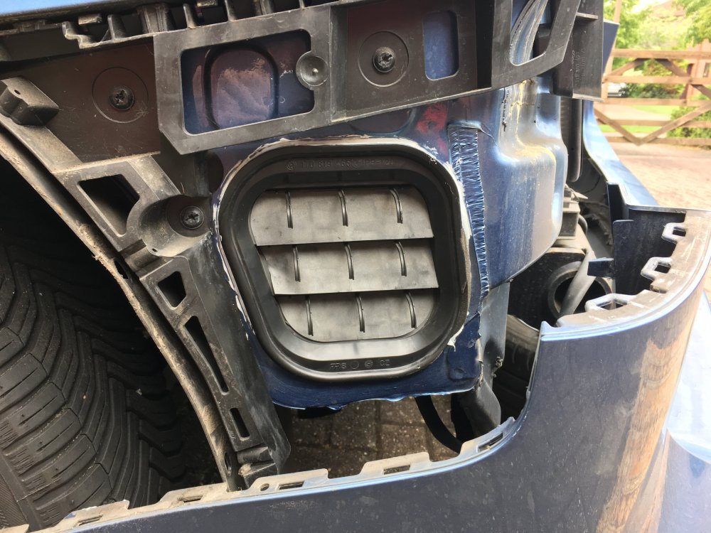

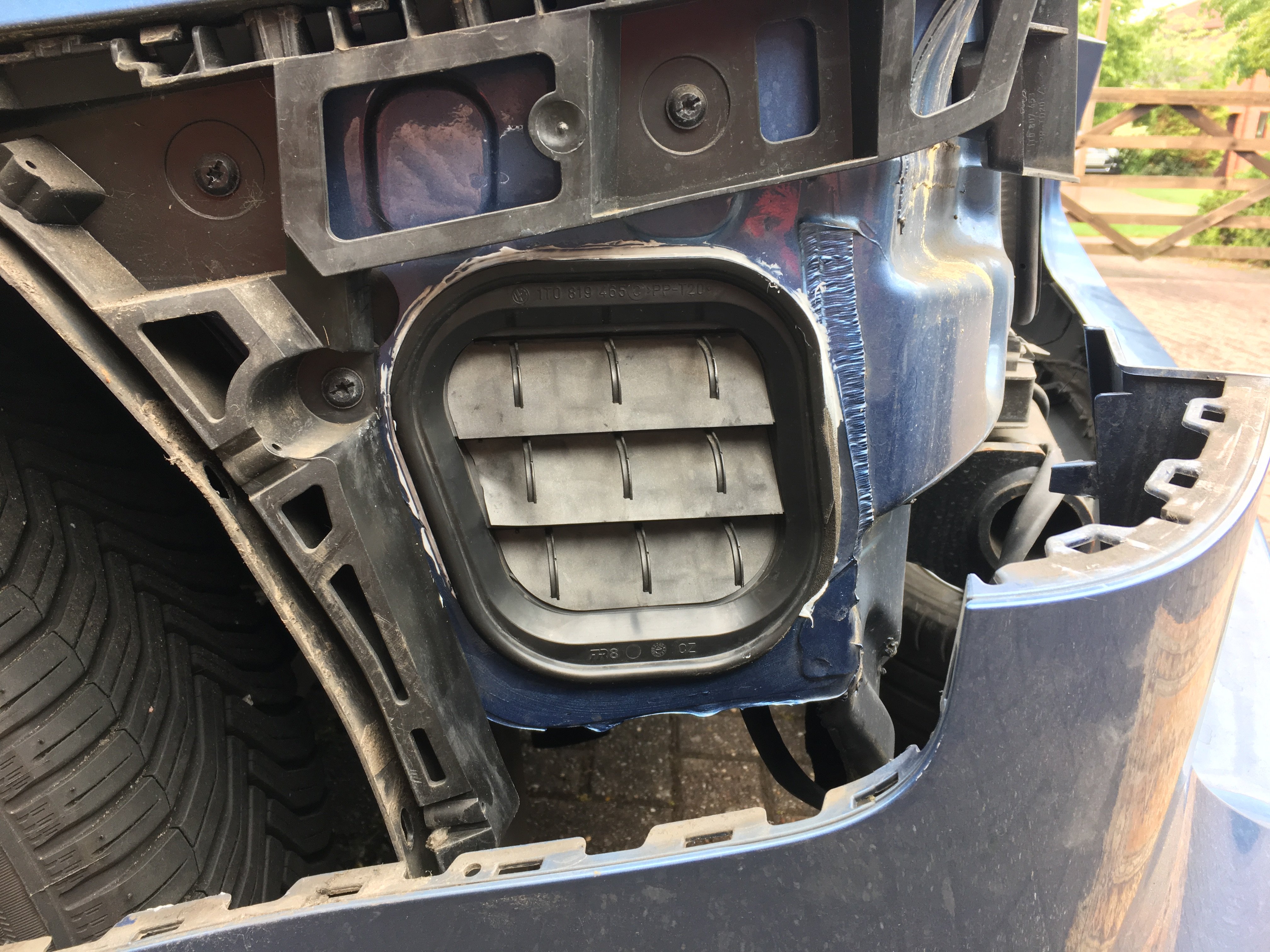

In addition to the washer pipe and sunroof drains you might what to check these two things. I found water in the spare wheel well of my Touran and in the storaae compartments in the rear wing behind the rear lights.
Many VAG vehicles have vents behind the rear bumper quarters, (Golf, Touran, Karoq etc) these can let water into the boot area and it can collect in the spare wheel well. This photo is from my Touran . The VW forum suggested this could be the cause if the vent seals had gone - as it turned out this was not the cause.
After a lot of investigation by a bodyshop, which entailed removing all the interior trim in the boot area they found that the rear hatch rubber seal had been fitted wrongly. The join in the rubber seal was half way up on the left hand side of the opening, it should have been in the middle at the bottom. Difficult to indiciadentify but a simple fix, fitted correctly no further problems.
