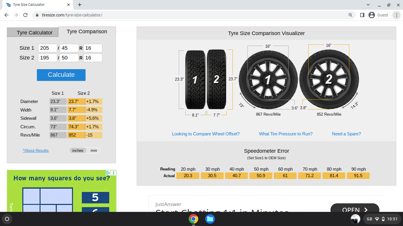

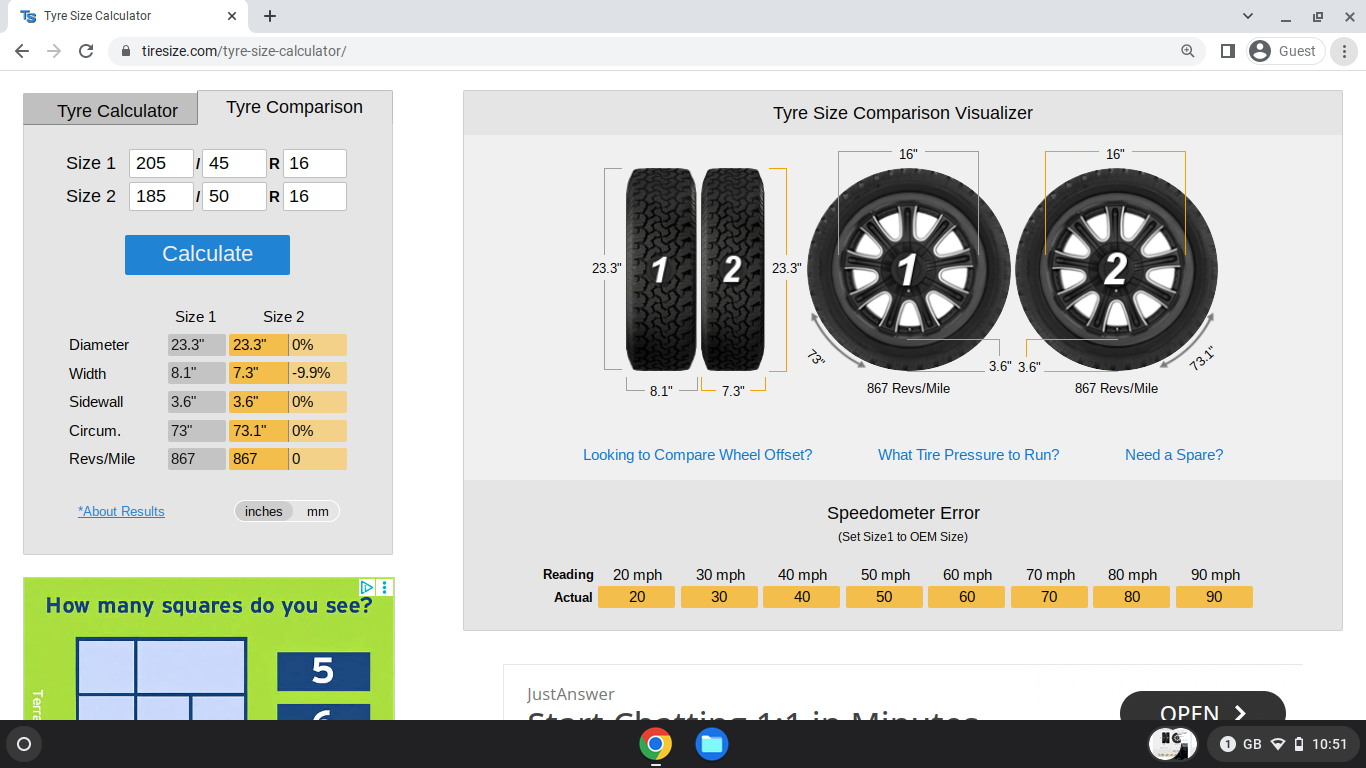

Why not go 195/ 50 R 16 with the wheels you have. & Maybe all season tyres.
@Carlston could tell you sizes, or look at the many many similar threads on this forum on wheel sizes and tyres.

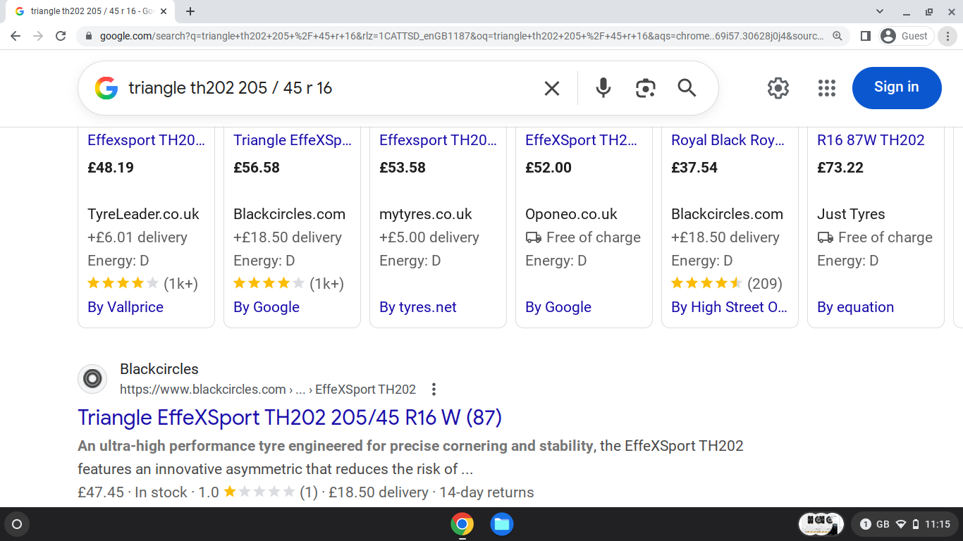

Are the tyres on XL / Reinforced sidewalls?
EDIT, sorry missed some of your post.
so not XL just these....
