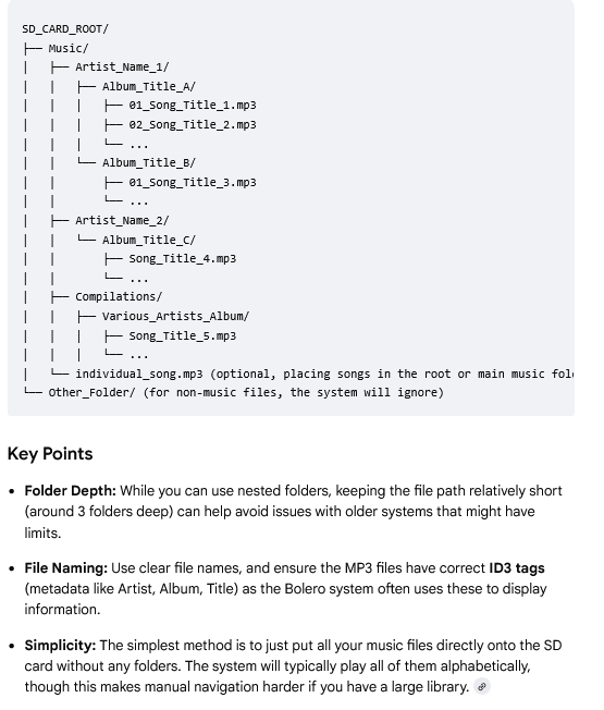

They're all in a single flat folder, in the root of the SD card. Maybe I'll stick a few into a folder and see if that makes the stereo notice the difference!
Thanks for the suggestions, all.
AI answer
Screenshot 2025-11-11 at 21-38-56 file structure for music on an sd card for a bolero in a skoda - Google Search.png
Well, I copied the new files into a new folder on the sd card. They play fine from there in the car!! But it still won't recognise the same files that are still in the root of the sd card. 🤷‍♂️
If I remember correctly there's a limit to how many files in a single folder the Bolero can handle, as well as the overall track limit.
I did Google this, and the internet suggested the limit was several thousand... 4000 I think 🤔
