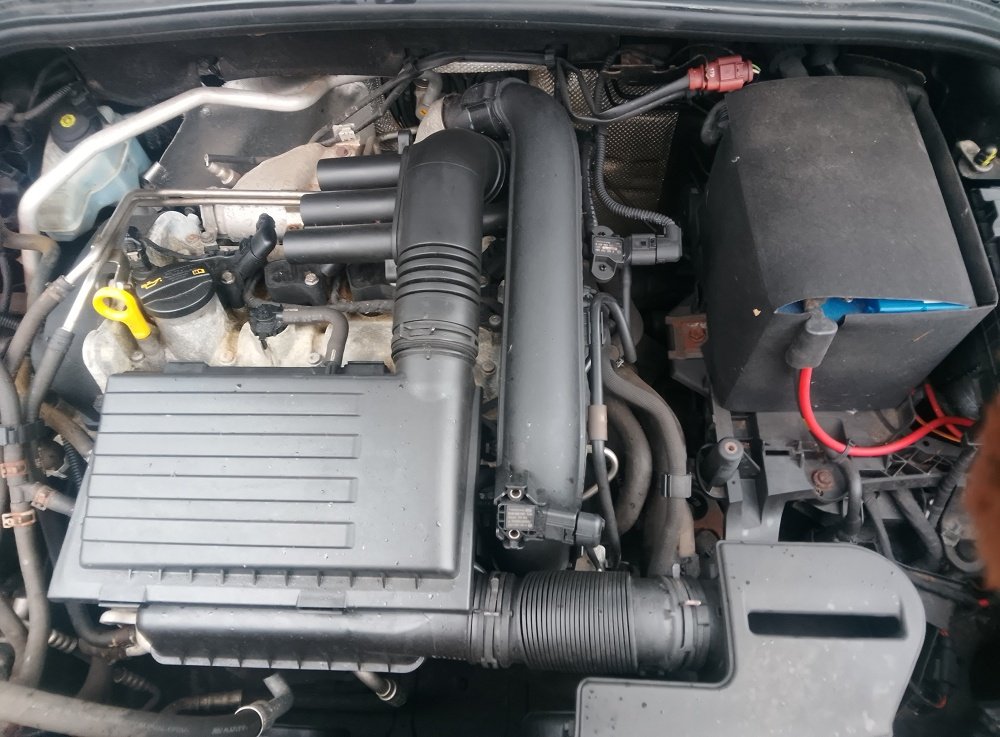

Would anyone be kind enough by marking the image below, show me where the plastic pipe from the brake servo to the inlet manifold under the throttle body is located?
Trying to investigate an EPC warning light issue for myself but don't have a workshop manual to show me around.
I'd think that you will need to remove the air filter assembly to help you to dig deeper, the throttle body is what the RHS big plastic charge pipe is connected to low down at the front near the radiator.
I've never tried to find out where exactly the brake servo vacuum source is - yet.
Edit:- something makes me think that the long stiff/hard small sized plastic pipe is the one, as it has a pressure sensor - which you can see on your picture "near" the battery.

I had that hard plastic pipe split on my Fabia, all strange things happened including losing the cruise control, I bodged it with some electrical insulating tape until I got a new pipe from the dealer, strangely although braking was affected it was not too bad.
Edit, follow it back from the servo, it was split on the other end.
