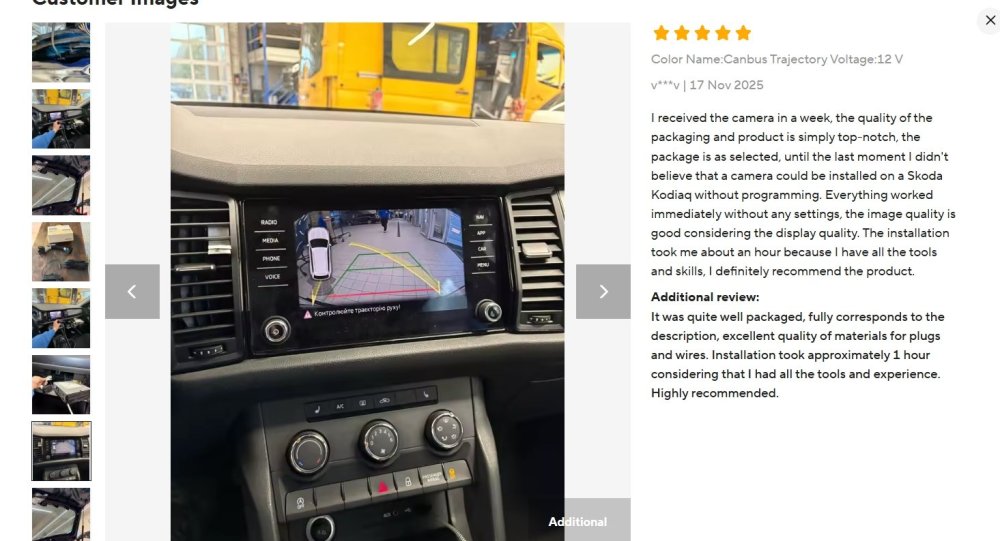

I thought the one with the round knobs/buttons was the Amundsen but the review on Aliexpress for the camera shows that model but the description says MIB2
Canbus Dynamic Trajectory Reverse Camera For Skoda Kodiaq 2016~2023 MIB2 STD HD Parking Backup Camera Work With MIB2 NAV Unit - AliExpress 34
