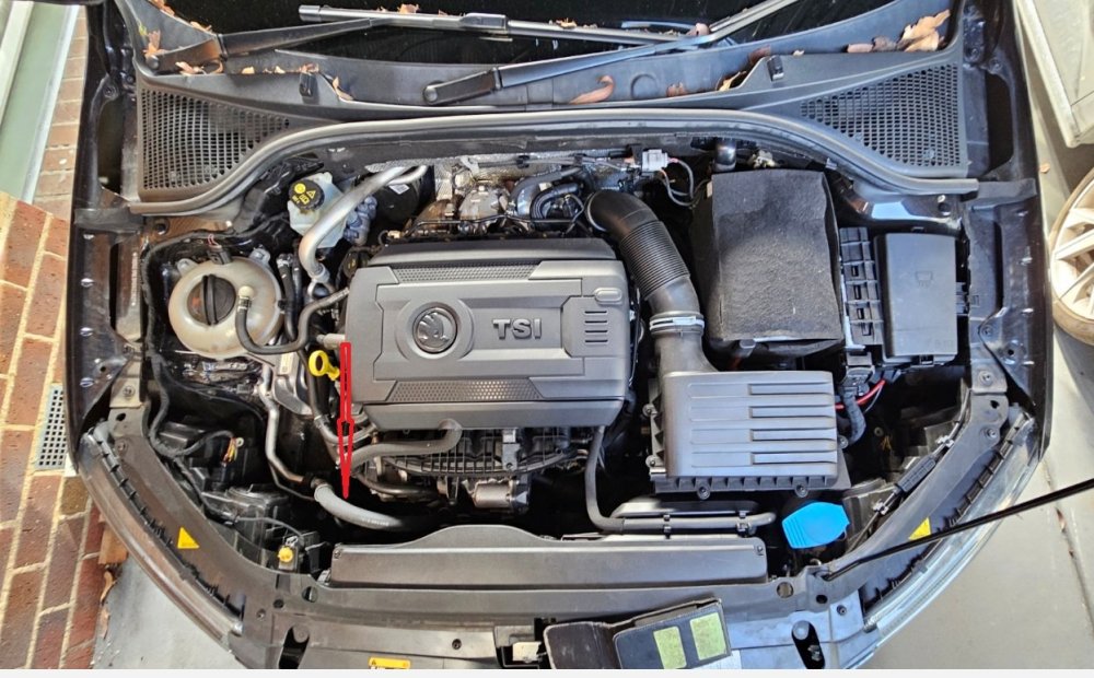

Looking around on YouTube , I am confused as to where the sensor is:- with one video indicating there are 2 sensors.

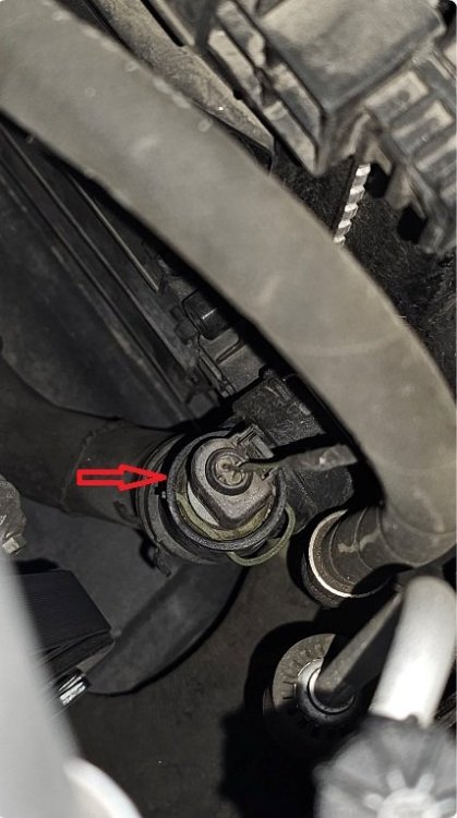

Many videos show that there is quite a disassembly effort required to access the sensor. I think I have found the sensor
directly with relatively easy access directly behind the radiator [see pics].
I would appreciate if someone can confirm this, before the result is worse than what I have now.ECT sensor.jpg
Generally the temp sensor is located close to, if not directly screwed into the thermostat housing as this is the closet place to the engine. In your pic this sensor is someway from this point and wouldn't give an accurate reading plus it's only held in with a clip, temp senders are normally threaded connections. I'd suggest whipping the engine cover off and look for where the stat housing is and go from there. They are usually quite small phyiscally with either a blue or green electrical socket but can also be grey with a brass hex head.
Hope this helps
Steve
Edited by steveo82
The sensor shown in your photo - at the back of the radiator - is not the Engine Coolant Sensor. It is the Radiator Outlet Temperature Sensor.
The main Engine Coolant Temperature Sensor is normally mounted to the cylinder head or thermostat housing. I would expect cylinder head. Mine is at the back of cylinder head but I don't have same engine as you. Do some research for location and look at suppliers for what it will look like. Good Luck.

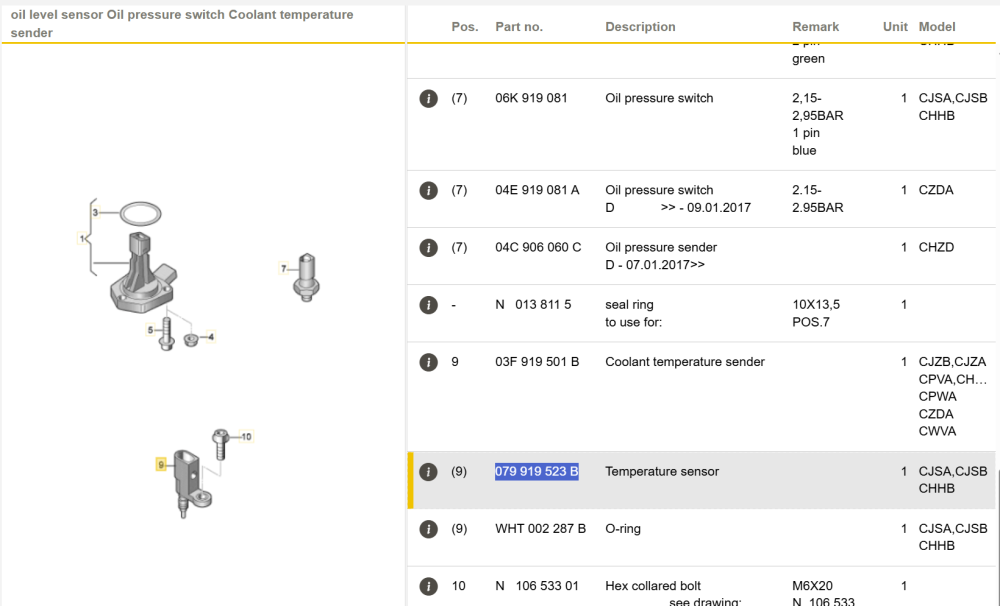

I'm seeing a different part number for the coolant temperature sensor in the engine, and a different appearance.
Not sure where it's found though:
