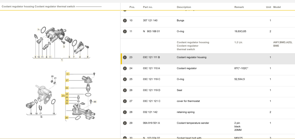

This is a screenshot showing the correct part (or sub-parts such as the thermostat itself and its o-ring seal).
I know, it actually looks like it'd fit, but knowing me it'll destroy something else if I went ahead.
