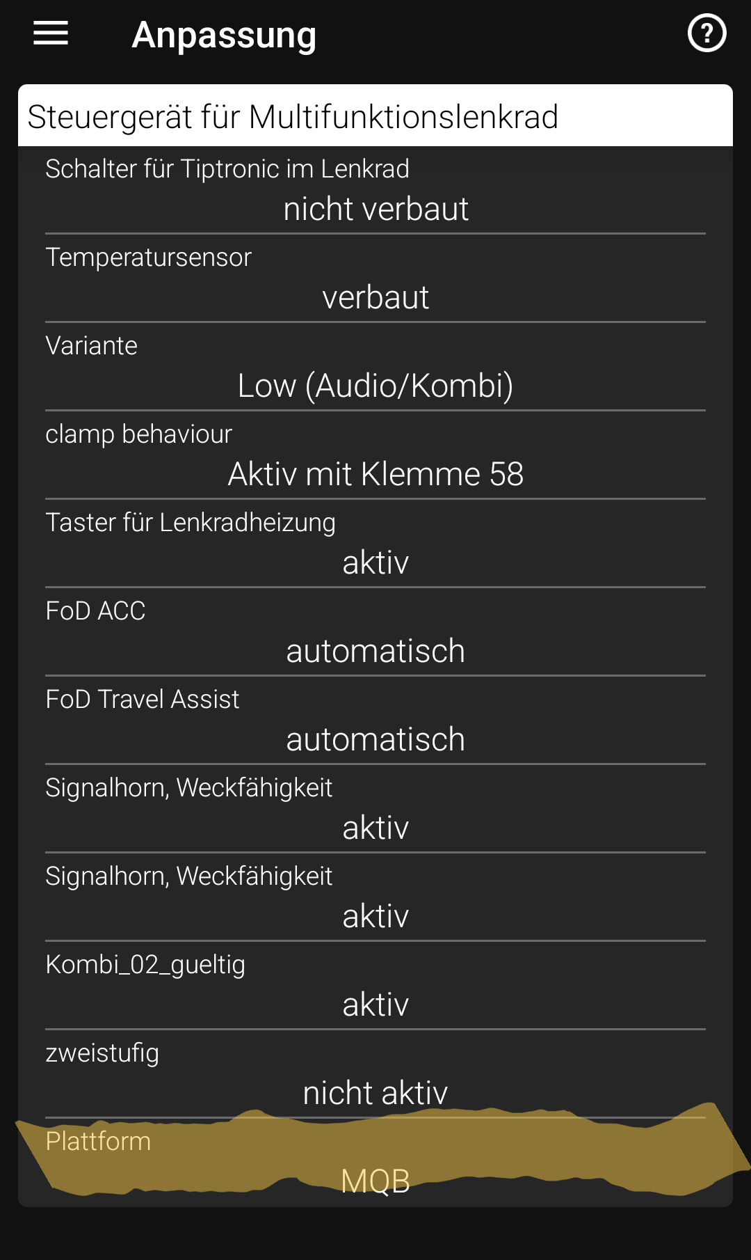

I retrofitted heating steering wheel to my Skoda Superb MY2020.
It's a face lift model, but it came from factory with "old" steering wheel - as many of early lift models.
From factory the steering wheel was heated.
But now I changed the steering wheel to the "new" one with capacity sensor.
I coded everything properly, but from the button on steering wheel I can only turn ON/OFF heating. I know there is a possibility to turn on the 3 level of heating option.
I'm starting assuming that it might be because of low FW version in my HVAC panel.
I think it will work with 3V5 module, but I want to try code it in this panel.
Do You have idea what else I can do?

IDE15331-Multifunction steering wheel extended adaptation    Configuration 1     3
MAS16372-Security version number    3    2
SFT271921-IDE02583-Multifunction steering wheel control module-Steering wheel Tiptronic switch    installed     3
SFT271921-MAS02311-Multifunction steering wheel control module-Steering wheel heating button    active     3
SFT271921-MAS04733-Multifunction steering wheel control module-Two-stage    not active     3
SFT271921-MAS06614-Multifunction steering wheel control module-Variant    Low (audio/instrument cluster)     3
SFT271921-MAS09758-Multifunction steering wheel control module-Temperature sensor    installed     3
SFT271921-MAS13892-Multifunction steering wheel control module-Platform    MQB     3
SFT271921-MAS19104-Multifunction steering wheel control module-Alarm horn wake-up function    not active     3
SFT271921-ENG258379-Multifunction steering wheel control module-clamp behaviour    active with terminal 58     3
SFT271921-ENG260738-Multifunction steering wheel control module-FoD ACC    automatic     3
SFT271921-ENG258784-Multifunction steering wheel control module-FoD Travel Assist    activated     3
SFT271921-ENG262857-Multifunction steering wheel control module-Kombi_02_gueltig    not active     3
