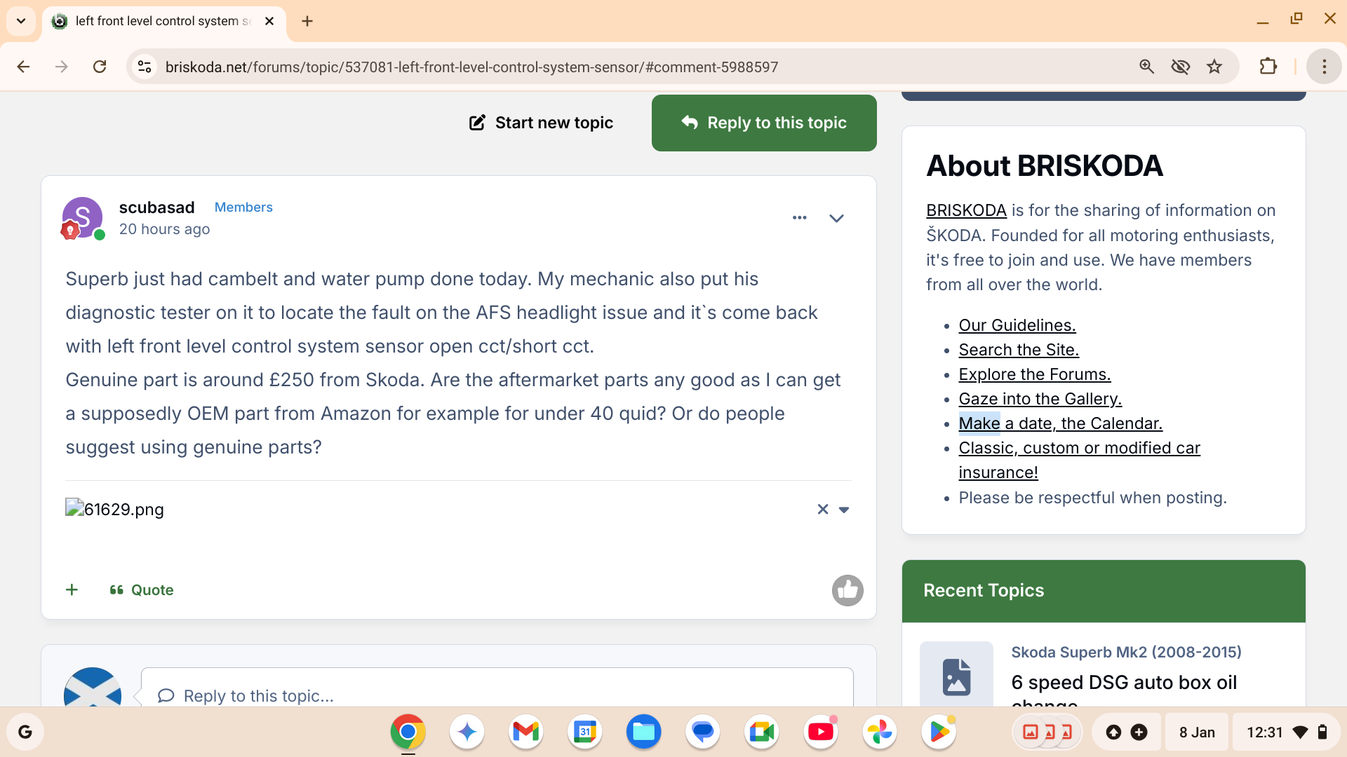

@scubasad You never mentioned that cambelt change in this thread. So what engine has the car and how old? I see the 138,000 miles covered. EDIT / PS. now i see in another thread. ??? Is it a 2.0 TDI then?

yes it`s the 2.0 l tdi estate. Lauren & Klement version
