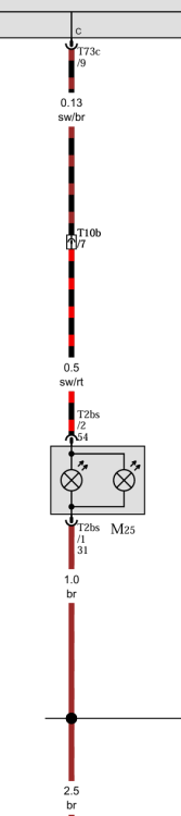

Circuit for high level brake light in your car looks like this:
I think you said that if you stick 12V up pin 7 of the 10-way it works well, so I have to speculate that either the BCM isn't giving the right output on pin 9 of T73c, or there's something wrong with the wire between there and the 10-way connector on the left in luggage compartment.
So stupid question, is there an easy way to check connector t73c? Which is part of the J519 as from what i can tell its up vehind the fusebox in the dash on the drivers side. All id need to do is stick 12 down the pin and see what we get at the light if it dont work then its the wiring i guess. If it does then 🤷🏼‍♂️
