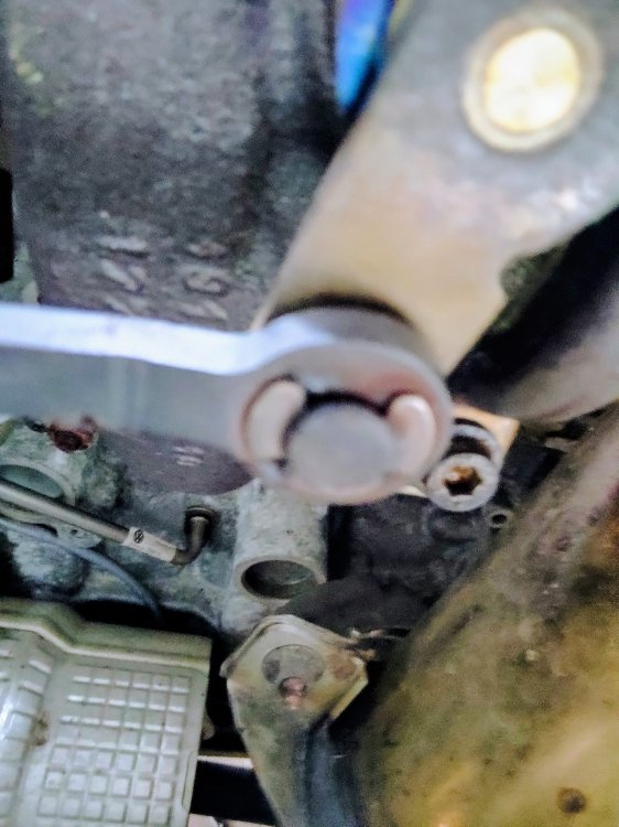

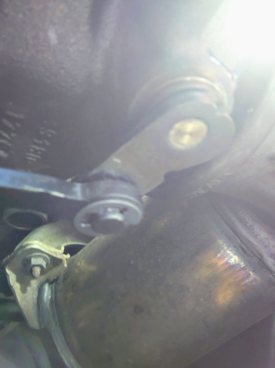

So, after doing some research, hopefully I've fixed the issue.
VW/Skoda do a new arm and e-clips for around (£65 ish) from various eBay suppliers. It doesn't look like the clips are available separately.
So I had a go at a DIY fix.
I got some replacement e-clips from a fixings supplier to suit a 10mm OD rod (£5 for 10 Inc postage) and some nickel based anti seize (1300°C) £8 including postage
First I removed the heat shield from the top of the turbo - 1 no. 10mm hex bolt and 3 M10 xzn/splined bolts to give me a bit of room.
The OEM e-clip broke into 3 bits and was corroded onto the bar & pivot.
I had to lever the actuator arm off with a combination of ever increasing flat head screwdrivers and hammering a old ½" extension bar against it and it eventually came off.
(I did begin to panic halfway, when it was stuck, completely jamming the wastegate)
I then cleaned both pivot and bar with 240g wet and dry, then wiped them with brake cleaner.
Then applied the nickel anti seize to bar and pivot. I stuck a new e-clip to the pivot with the same anti seize to prevent it falling off and pushed it home with a screwdriver. Then wiped off the excess anti seize.
Before
After
Sorry about the quality of the pictures, not much space to work in.
Hopefully this'll help anyone else with the same issue.
Looks better than new. Mine was the same although I admit I just oiled and moved it till everything was moving freely then added some copper grease as I had a tin handy.
Nice tidy job
Alasdair
