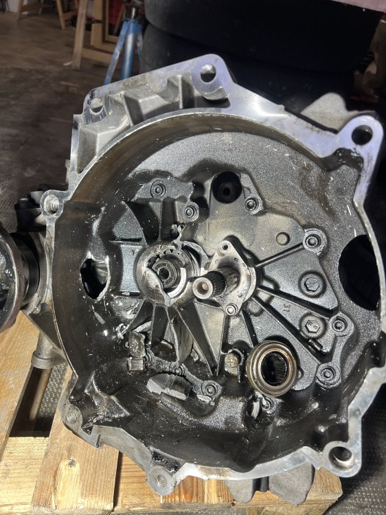

nope same everything, just different tune and gearbox, i've tuned my cbza to 140 bhp with a non completely healty gearbox (MFX) bit of whining noise diff noise, all gears whining, so tuned and Yokhoama semislick (ad08rs) destroyed the gearbox (due also to vibration from all bushing in polyurethane 90 shore koni yellow hard race brace and other things) so, I've used an LMG gearbox that is a standard one for the 105 bhp cbzb same bolt pattern same starter motor same clutch and flywheel same driveshaft the lot just different shaft bearings and stiffer component in the gearbox (I can tell you 100% sure because was all DIY done by only me) i can provide you a couple of vin sourced from junkyard of fabia with cbza and cbzb so if you look on skoda-parts.com you can check te various parts

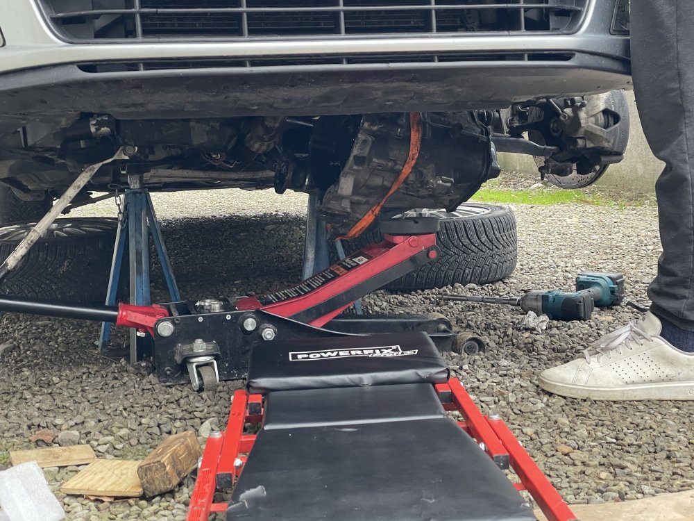

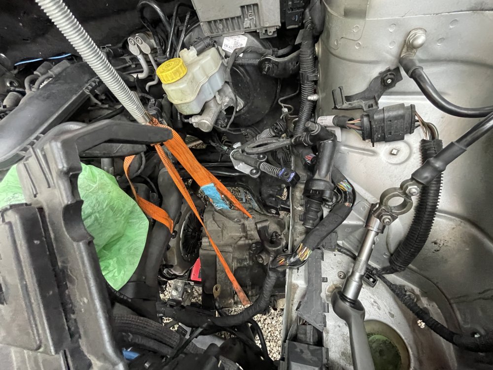

ok got it, if i can give some advice, (i don't know if you have done it yet), to remove the gearbox disconnect both driveshaft, you can remove just the shorter one (in UK the passenger side one), and start to loose all the gearbox housing bolts, do not remove them yet, remove the lover mount (pendulum mount) use an engine stand like this: https://www.google.com/url?sa=t&source=web&rct=j&url=https%3A%2F%2Fwww.ebay.co.uk%2Fitm%2F374957660842&ved=0CBkQjhxqFwoTCPi6lZ2ZnZMDFQAAAAAdAAAAABA-&opi=89978449
place and tight a ratchet straps around the gearbox be sure to not damage te reverse switch and attach it in one of the hook of the engine stand, the other hook place it in the engine 'holder' located btween the charge pipe and the tsi cover, remove the right upper gearbox mount, then remove the previous loseen bolt, then you will be able to move the gearbox eiggle it a bit just to fee it up, lower the hook of the engine and simultanusly lover the gearbox, from the passenger wheel well you will be abel to see the two bolt that old in place the gearbox mount, a black c shaped bracket, once removed you will be able to lower the gearbox lowering gently using the hook, to install is a reverse order, but for the c bracket, you will need to bolt in the gearbox first then lower the engine bolt-it back and you're good, for the clutch pressur plate you will need a 12 point socket, i'vw used this set: HASKYY https://amzn.eu/d/0ce3Z97n the pressure plate bolt are this one https://www.skoda-parts.com/spare-part/n90320701-clutch-screw-m7x14-germany-oe-producer-10902.html to lock the fly wheel i've used this tool BGS 9616
