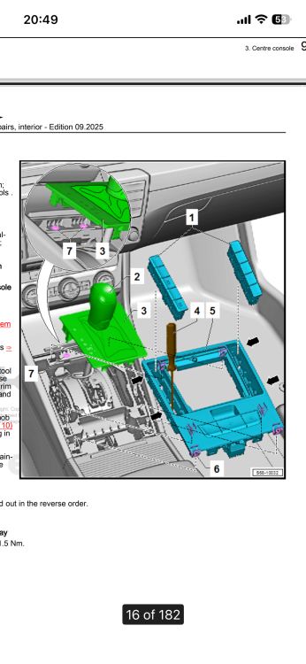

I’ll screen shot the pages from the manual for you

This is as much detail as the manual shows. You can lift the trim, disconnect the switches from each side of gear stick and parking brake switch and then press out the other trim round the gearstick and twist it through the hole in the outer frame to take the outer frame off completely. But I don’t think you would need to do that that get the ashtray out. Just release it and push it back far enough to get to the two screws (7) in the image.
If you do disconnect plugs from the switches and parking brake etc you will get all sorts of errors. Dont worry they will clear when you plug everything back in.
It doesn't look too scary now! Thanks
