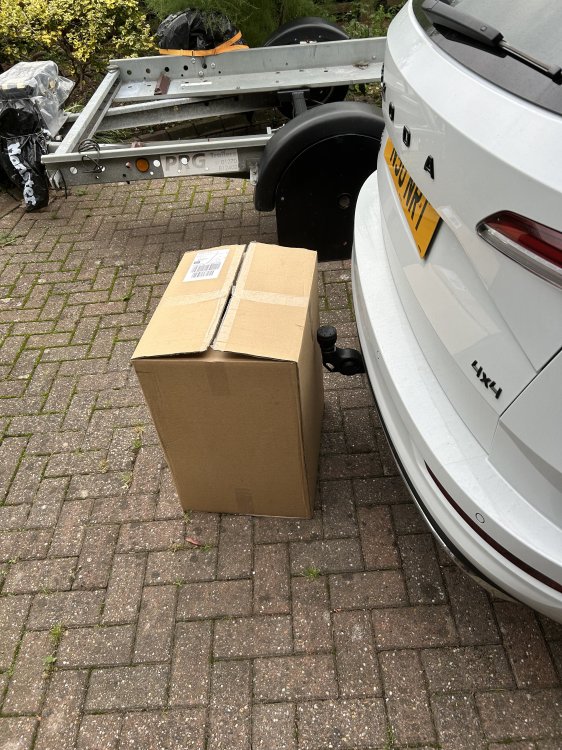

I retrofitted the Park Assist on my 22 Style FL (it's like a SEL), as well with Area View 360° (I was lucky enough to find the mirrors): they definetely worth the expense, that is about 1000 Eur including the painting of side sensors! If You want to upgrade just to PA, I recommend You to put the high reverse camera with dynamic guidance lines!
When getting the control unit look for 5QA for PLA 3.0, definitely better than the 5Q0 for PLA 2.0: it's more accurate!

Done a couple of jobs for me (Seat Arona and Skoda Karoq) and can highly recommend them.
https://www.mobileincar.com/
