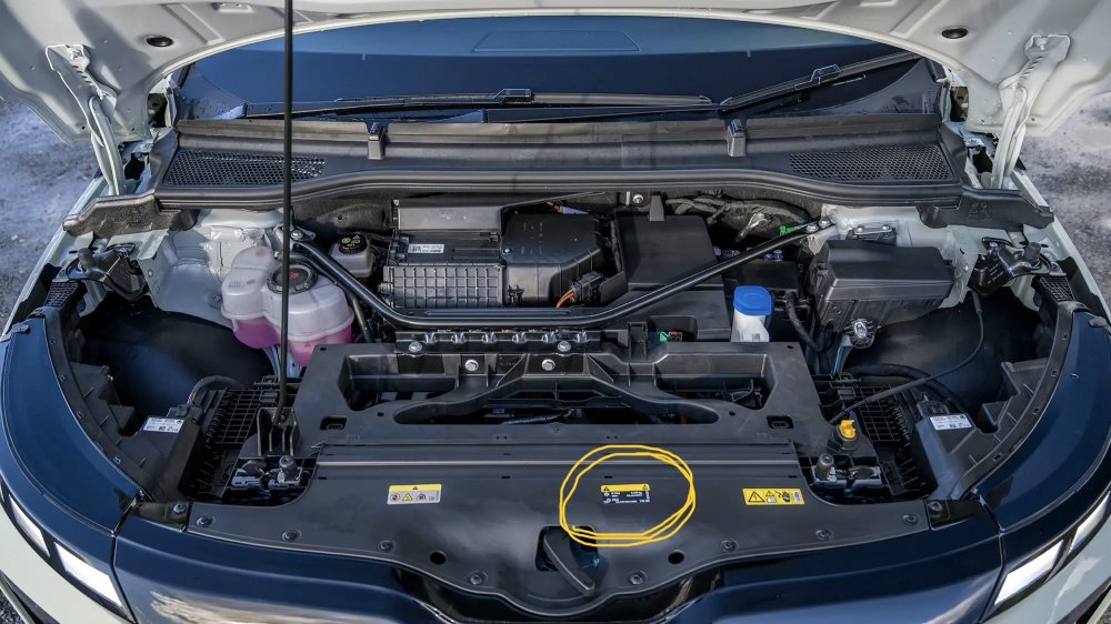

Heat pump refrigerant will be R744 and you can see it on one of the yellow stickers under the bonnet (circled on the photo attached). This is the easiest way to check.
