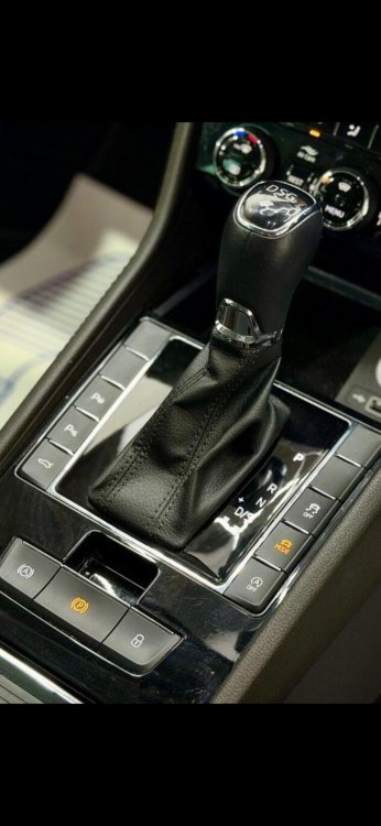

Are any of these buttons to do with it?
@SteveSupurb - these r the meanings of those buttons....
Thank you.
