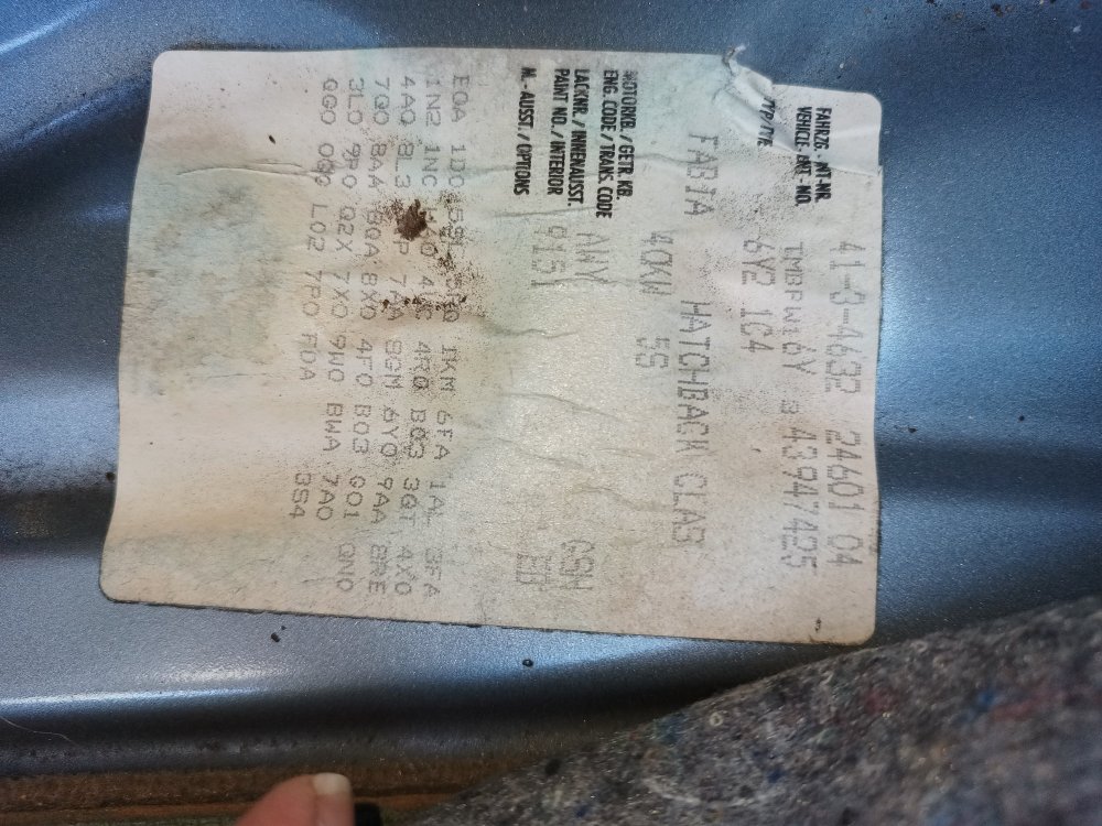

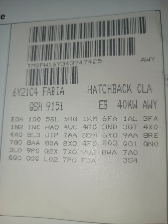

If the build sticker is still present and readable near/in the spare wheel well, it will have transmission code on the same line as engine code, I think.
Post a photo if you find it but aren't sure what you're looking at.
Please see attached. There are two slightly different versions of the sticker, one in the service book and a mouldy one in the boot. Looks like the gearbox code is just "GSH" (with the 9151 following it in the service-book being the paint code). That would also be consistent with the table you posted later. The suggested search term "GSH gearbox" seems to give appropriate hits on ebay, so I will double-check with the garage and try that. Many thanks for everyone's help, much appreciated :-)
I notice that sometimes there is a manufacturer's code, e.g. "02T300053D". Would someone please happen to know how that relates to "GSH" and where on my car to find it if it provides better information?
