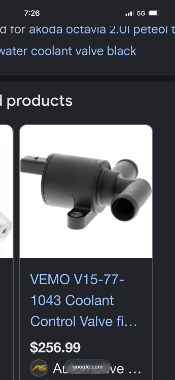

Update from mechanic. Coolant control valve confirmed to be faulty. Also changed temp sensor after that valve considering the games it was playing on me. Mechanic also mentioned all the crystals inside the coolant bottle had burst and been circulated through the coolant system so suggested best to drain everything and replace with new coolant bottle with fresh crystals. Never heard of these before. Pic of what I think the issue was with - I saw it on the bench and it looked just like this.
