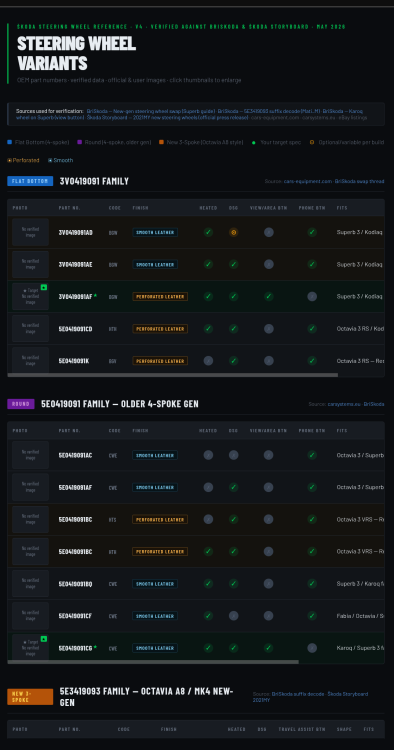

  • So, my friend John Claude made a chart. Steering Wheel Guide Link skoda_steering_wheels-1.html
  • I'm back with a another update! Version 7 - Download the HTML to view. Notes: Here's the verified V7 chart. Click the amber banner at the top to see the full changes log. Here's a summary of what was

Ah, sorry, you miss understand me. I am creating this list for everyones use, primarily i set it up for myself.
If anyone can contribute or spot an error I would be grateful!
Notes: Here's the verified V7 chart. Click the amber banner at the top to see the full changes log. Here's a summary of what was found and corrected across BriSkoda, Polish SuperbClub, German SkodaCommunity, and Allegro.pl.
Updated images to SVG renders.
skoda_steering_wheels_v7.html

I found the same part number elsewhere too. It hadn't been previously picked up by my AI chart.
From my research:
Heated: ✗ — CWE on the 3V0 family denotes non-heated smooth leather (BGW = heated smooth; CWE = non-heated smooth on 3V0 platform)
skoda_steering_wheels_v10.html
