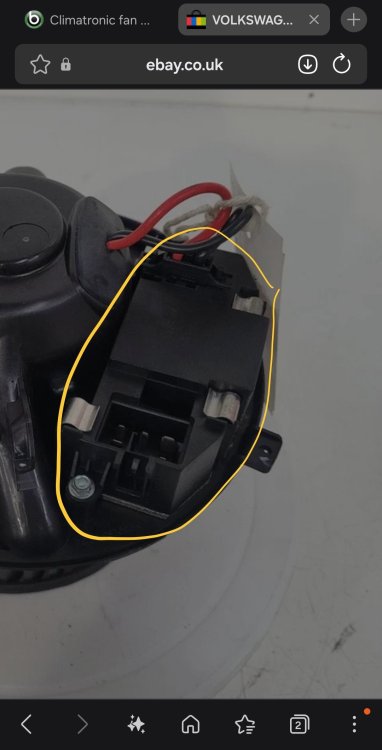

Just for extra clarity, the solid-state power controller for the fan is the part ringed in this photo, from an eBay listing of the part number quoted by the OP.
