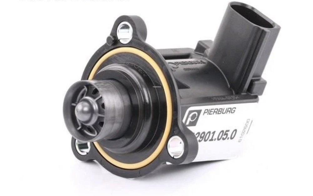

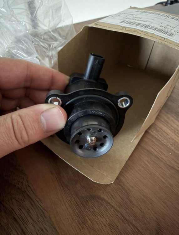

New PCV valve
New Air/Boost pressure relief valve (by the turbo after the air intake pipe).

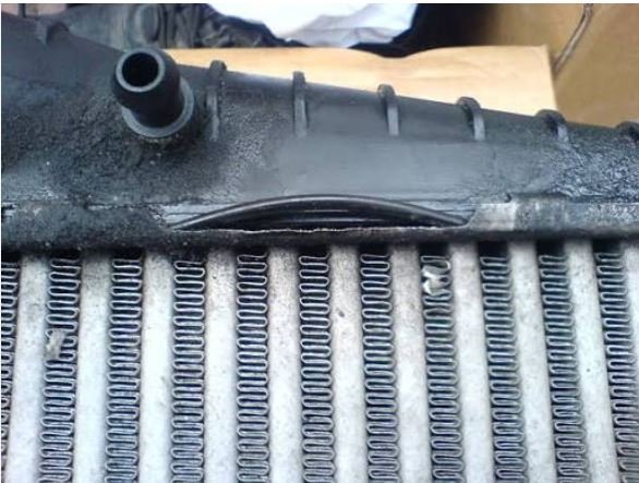

Entire intake and charge system stripped, checked for cracks and any blockages. Every pipe and clip inspected, even a camera inside the intercooler.

Sound is located on the right hand side near the air intake, valve dropping/diverting excess boost back in the air box.
