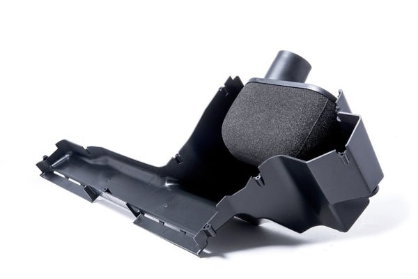

Regarding induction kit i decided to keep standard airbox in but used Ramair panel filter. ECS tuning intake duct took care of that dreaded blocked intake and was only under £200 from Awesome GTI and still looks fairly OEM.
None of the after market intakes will unblock the closed off air flow behind the grill.
All they do is remove the blocked section on the intake itself.
Essentially it's like having a blocked nose on one side.
U can see in the first image that the air intake on the right, even when unblocked, is still blocked by the flow coming through the front grille.
I don't know why Skoda does this.
To remove the restriction, u need to remove the front bumper and dremel (cut) out the plastic trim on the right side.
I did this to mine a long long time ago.
If u want to take full advantage of the factory intake or aftermarket intake - u need to unblock the air flow on the right side.
Factory setup has the right side airflow blocked.
Air flow into the air intake (top) blocked on right side.
Close up of the blocked air flow on right side, from factory.
Close up of unblocked air flow on left side, from factory.
Air flow into the air intake (top) after being cut out on the right side.
