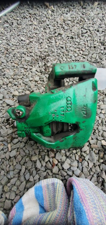

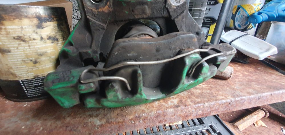

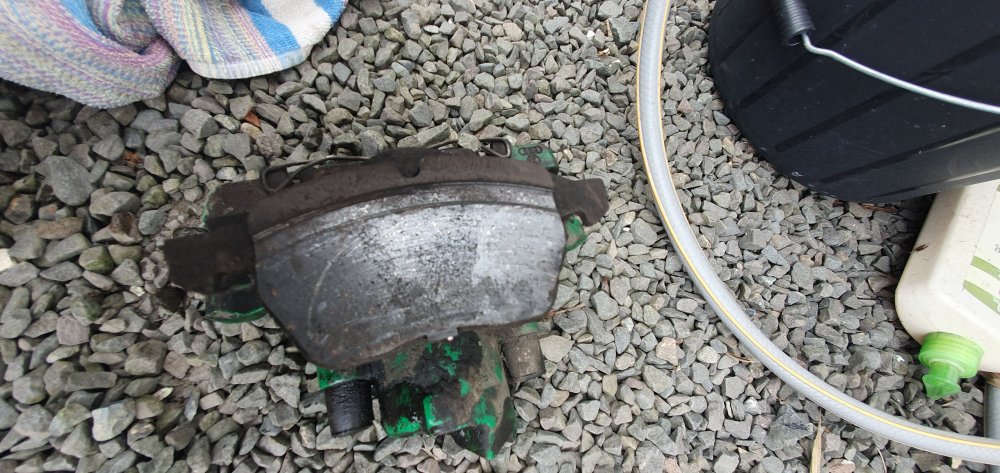

Can someone tell me if these are standard front calipers on my mk1 fabia vrs as when I go to car shop for brake pads get offered ones that don't fit
Quite possibly not original - I'd not expect to see an Audi logo on OEM Fabia calipers.
@mdfabia1969
There was a popular (NON Quattro) Audi TT caliper and carrier upgrade for the MkI Fabia back in the day which used 312mm discs so I'd measure your disc diameter in the first instance.
IIRC 310mm discs were also used.
