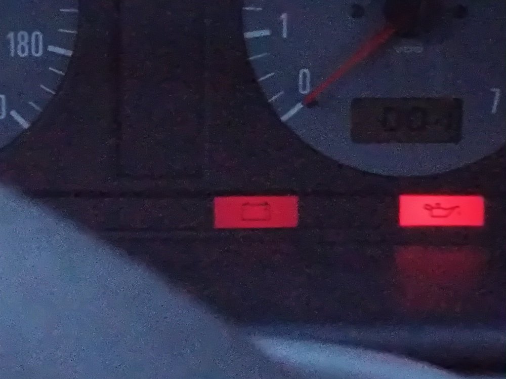

In the night, in full dark, I saw that the panel light for oil was slightly on (some current is being drained).

My guess is that the oil pump sensor switch is having an issue. I would appreciate any help in this topic.
