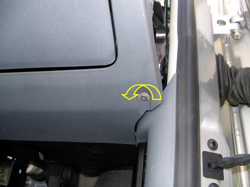

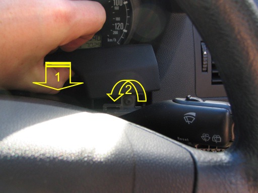

2. Pull the right side of the bit of trim above the steering wheel towards you (1), and then push it up a bit to allow you access to remove the Torx screw underneath (2):

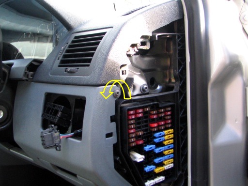

3. Now lever off the fusebox cover:
4. ...and remove the screw shown:

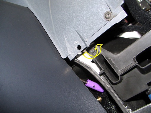

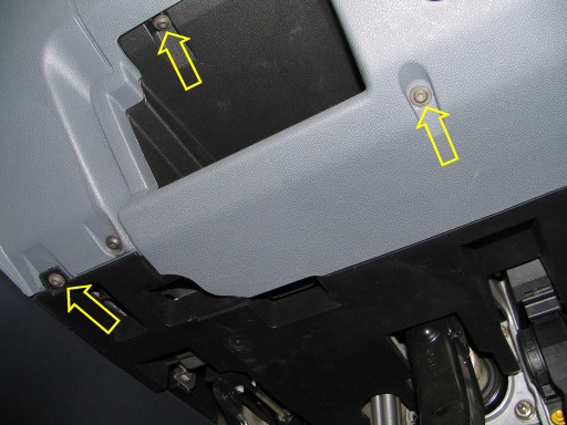

5. Now remove the three screws shown:
6. ...and this one, too:

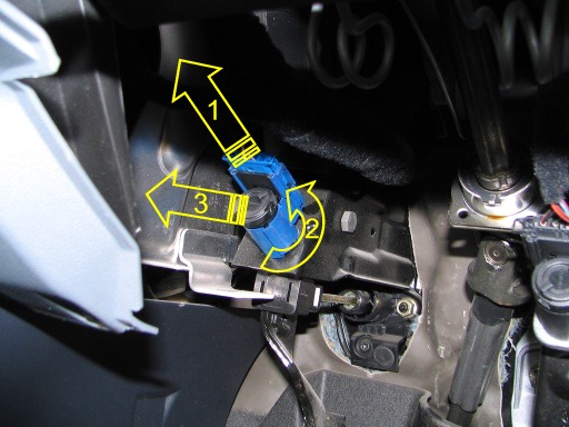

9. Disconnect the clutch switch (1), turn it 90 degrees to the left (2), and pull it out of its holder (3):

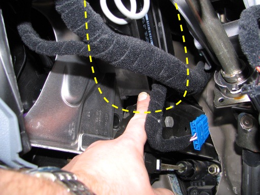

10. Remove the central locking ECU and its bracket. It's really tricky, so I ended up just ripping it off and busting the bracket in the process! This is easily done, apparently, and you can always just use a cable tie to hold it in place once you're done - no-one will ever know! :D):

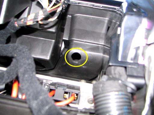

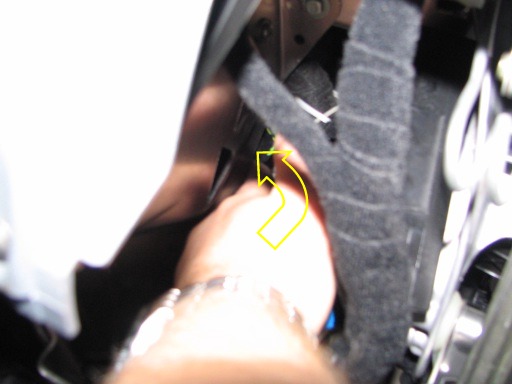

11. The sensor is up at the top somewhere. It's only held in by friction, but you will need to disconnect it from its cable, which I found quite tricky. If you get too frustrated, you could always leave it connected and snap the sensor to get it free - you're replacing it after all, and it should be easier to disconnect once it's hanging down where you can see it! The picture for Step 12 kind of shows you what you're feeling for (only the bit to the right of my thumb protrudes from the bowels of the car...)
