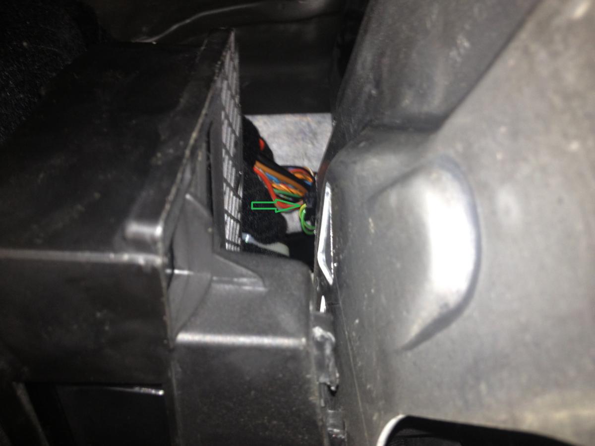

I'm on my back here looking up and, as you can see, I didn't remove the central locking unit as I simply couldn't get the cable header out.  My version had a sliding mechanism rather than lugs.
I broke the old sensor in removing it as it was just far too difficult to remove the wires in something that's held in by friction only.  A very frustrating part of the process - be prepared to come away with scratches all over your wrists here!!  My big tip for the whole job is how you put the new sensor back in.  Position the whole thing past the hole and then come back down... don't try to insert it from the driver footwell area!  Also, it goes in with the point of the bend towards the sky if that makes sense.  I did it the wrong way around at first and very nearly got it stuck and broken trying to remove!

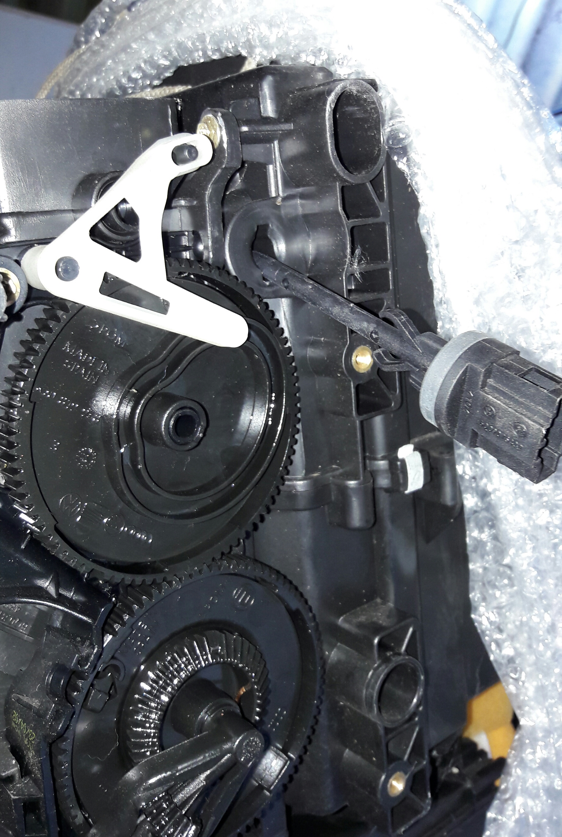

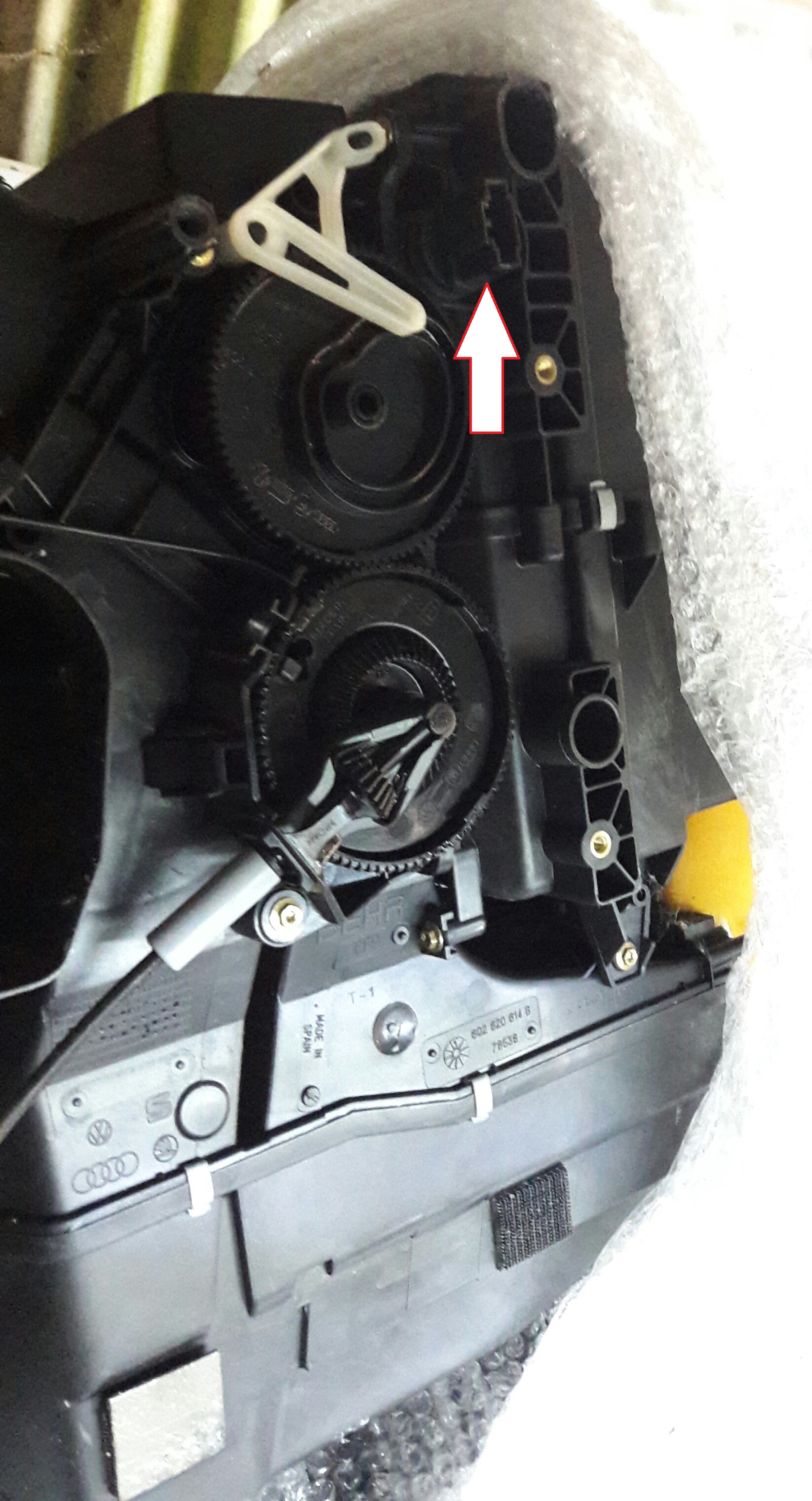

Because it's so hard to get a view of what you're doing down there, I found it took me a while to find the hole that the sensor came out of, when I went to fit the new one.
Hopefully this photo of the right hand side of the heater box assembly might help:
And here's one with the sensor half way out of its location to show the hole you're looking/feeling for when replacing.
