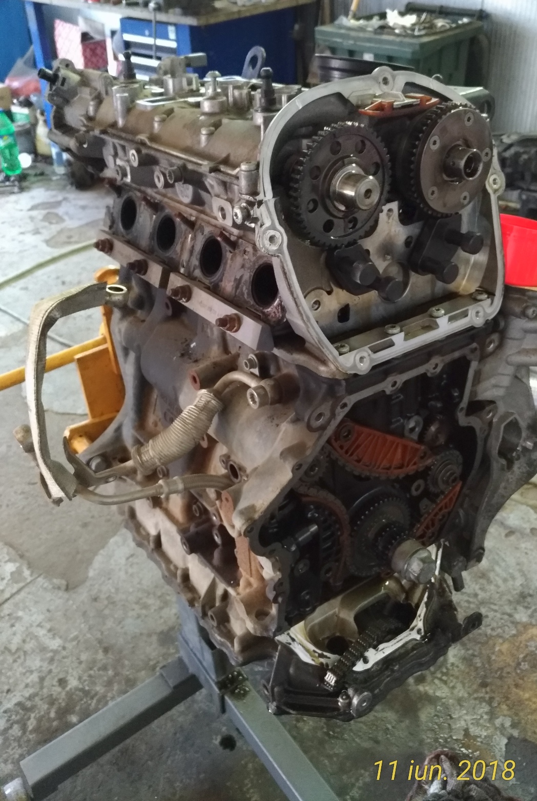

Looking back over my shoulder I could see what I said wrong and what was right about 1.8 TSFi excessive oil consumption.
First of all ADREHJ and RAYX pls have my apologies for contradictory opinion when you mentioned that is a must to replace the pistons and rings to control the engine damage beyond the reasonable repair point.
Now my ODO show 168K km and today I started to repair my CDAA engine after the consumption level reached a staggering 1liter / 1000 km.
Initial findings :
(1) cylinder 1 (next to timing chain) showed large deposits of burned oil than 2,3,4 and spark plug (replaced 8K before - Iridium Denso VK20)  having melted central electrode.
Engine was running OK but showed subtle signs of hesitation when lower rpm (1500 - 2000) especially when shifting.
(2) timing chain enlarged significant
(3) water pump cracked with leaking signs (up to 500 ml / year)
(4) clutch with burnout signs on pressure plate and disk worn out at max. limit (no slipping detected)
Tomorrow mechanics will remove the cylinder head and more news while the repair unfold.
First day conclusion: excessive oil amount that remain in the combustion chamber have the tendency to increase the burning temperature that lead to spark plug electrodes meltdown  and this start a chain reaction that will affect the engine functionality and its integrity so repair should be initiated when oil consumption exceed 500 ml / 1000 km.
Edited by safari hunter
