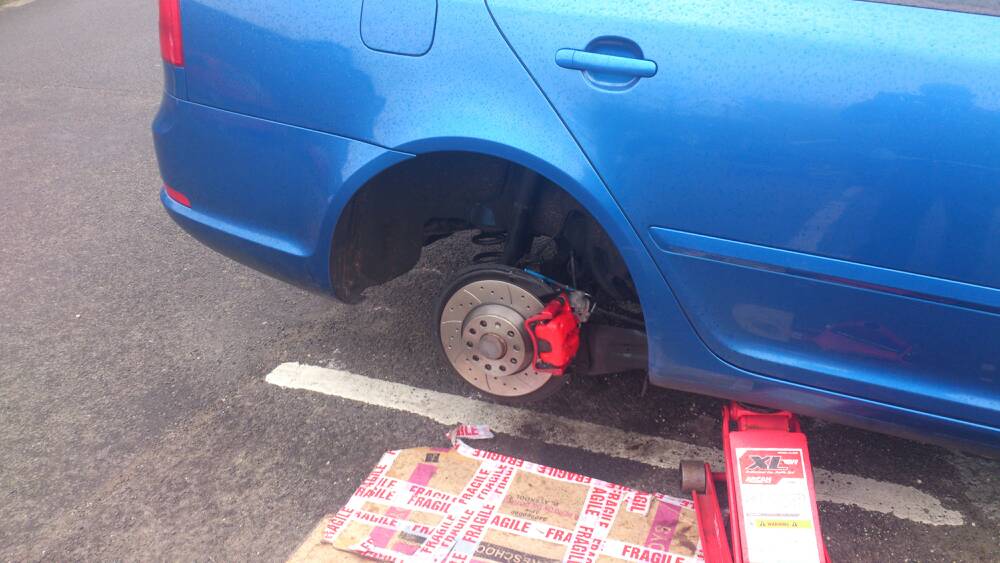

Im using them only had them on two weeks though they seem ok and look the part. Im using them with Skoda economy pads they don't squeel or clunk but the shims are a bad fit it's abit of an effort getting the pads lined up and clicked in especially the inner ones

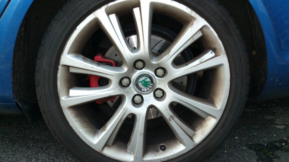

I have MTEC discs in just now. Just grooved and were coated black and mintex pads.
They seems quite good and the hub is still coated black so no rust there either. Obviously the face of the disc is no longer black however the grooved sections are. Looks good.
