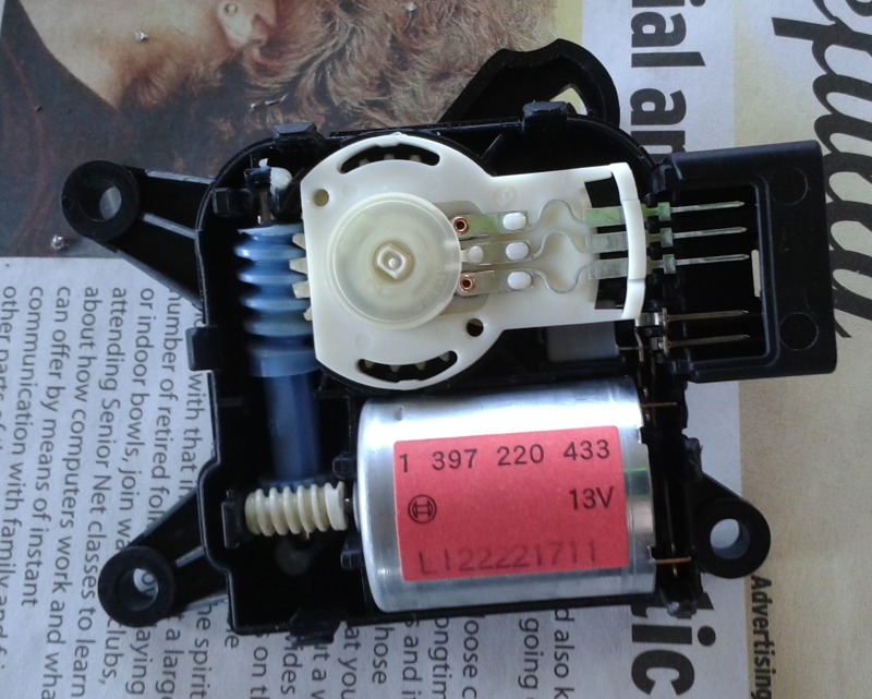

I prised the cover off the motor (a lot of clips) and started checking stuff. The motor resistance was good, the potentiometer resistance was also good so I wound it back to the middle and plugged it into the other side (not hooked up to a flap) for testing.
I hit the recalibrate and it moved fine, when I put it back on the original side it still moved fine so I put it all back together.
The motor position doesn't correspond to any particular temp, the programming behind it is quite complex. But the recalibrate will move to the motor to each stop and record the position.
Here is a picture of the servo motor open. Because it's a worm gear you can only turn it at the motor.
Thanks for the reply mate, I did take mine apart and It worked for a second or two when plugged back in then nothing.
